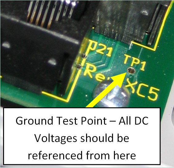

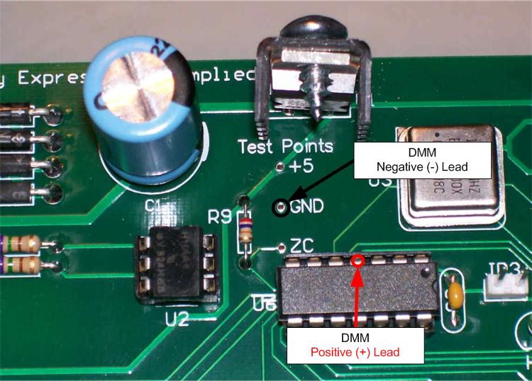

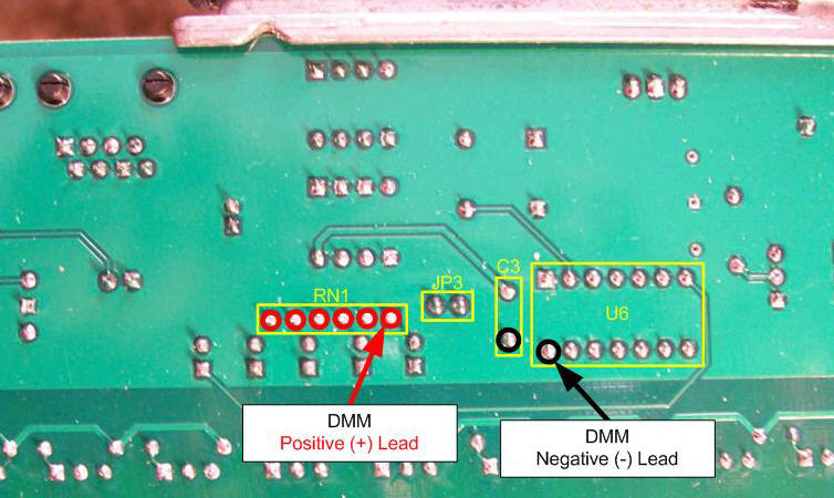

| All DC voltages in this document are referenced to GND. So for all measurements, the multimeter negative (-) lead, usually black, needs to be connected to a GND point on the PCB. The best location would be the GND Test Point TP1 located near RJ45 Jack J21. The positive lead (+), usually red, gets connected to the location called out in the procedure. |

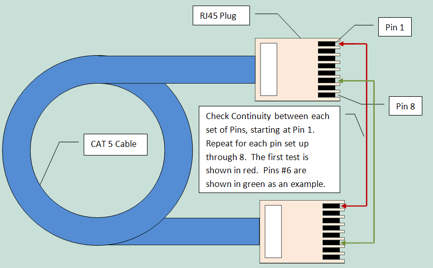

- Bad data cable coming from the computer. Many individuals assume that all serial cables are identical, but that is far from the truth. Just because a cable has the correct DE9 connectors on each end doesn’t mean that the wires inside are going to the correct pins for Renard operation. It is always best to physically check the pin continuity to verify that the cable will work for Renard operation. Make sure that your interconnect cable is wired according to the Renard 64XC Controller wiki.

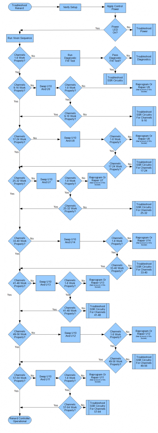

Troubleshooting Flow
The complete pdf version of this flowchart can be found here

- Verify that you have the power/control cables connected correctly as compared to the Renard 64XC Controller wiki.
- Verify that you have the Vixen plug-in settings correct as compared to the Renard 64XC Controller wiki.
- For the following steps, the PICs (U7 thru U14) need to be programmed with the Renard Operational Firmware.
- Turn ON AC power
- PWR LED should be lit
- If incorrect , then go to Troubleshooting Power Problems.
- Run a Vixen sequence
- Do Channels 1 thru 8 respond as programmed in the Vixen sequence?
- If they don't, then go to Troubleshooting Diagnostics Problems.
- If the diagnostic routine passed, then go to Troubleshooting SSR Circuitry Problems.
- Do Channels 9 thru 16 respond as programmed in the Vixen sequence?
- If they do, go to step 15
- Turn OFF AC power
- Swap PIC chips U10 and U9
- Turn ON AC power
- Run the Vixen sequence again
- If they don't, reprogram or replace the U9 PIC chip that you moved to the U10 socket and retest
- If they don’t, then go to Troubleshooting SSR Circuitry Problems.
- Do Channels 17 thru 24 respond as programmed in the Vixen sequence?
- If they do, then goto step 22.
- Turn OFF AC power
- Swap PIC chips U10 and U8
- Turn ON AC power
- If they don't, reprogram or replace the U8 PIC chip that you moved to the U10 socket and retest
- If they do, then your Renard SS24 Controller board is operational
- Do Channels 25 thru 32 respond as programmed in the Vixen sequence?
- If they do, then goto step 29.
- Turn OFF AC power
- Swap PIC chips U10 and U7
- Turn ON AC power
- Do Channels 33 thru 40 respond as programmed in the Vixen sequence?
- If they do, then goto step 36.
- Turn OFF AC power
- Swap PIC chips U10 and U14
- Turn ON AC power
- Do Channels 41 thru 48 respond as programmed in the Vixen sequence?
- If they do, then goto step 43.
- Turn OFF AC power
- Swap PIC chips U10 and U13
- Turn ON AC power
- Do Channels 49 thru 56 respond as programmed in the Vixen sequence?
- If they do, then goto step 50.
- Turn OFF AC power
- Swap PIC chips U10 and U12
- Turn ON AC power
- Do Channels 57 thru 64 respond as programmed in the Vixen sequence?
- If they do, then goto step XX.
- Turn OFF AC power
- Swap PIC chips U10 and U11
- Turn ON AC power

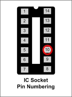

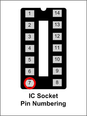

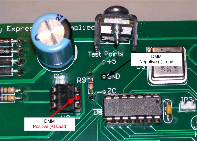

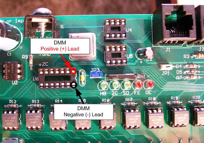

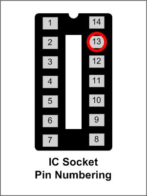

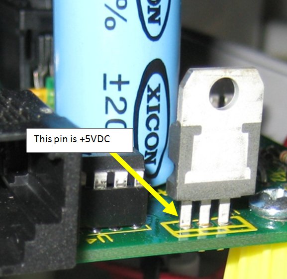

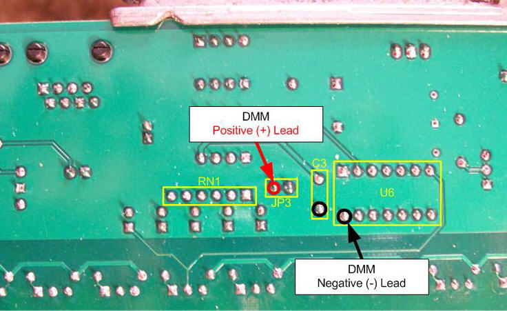

- Measure DC voltage at U1. This is the lead closest to U4.
- Voltage should be +5 VDC +/- 0.05
- If incorrect, go to step 13(??)

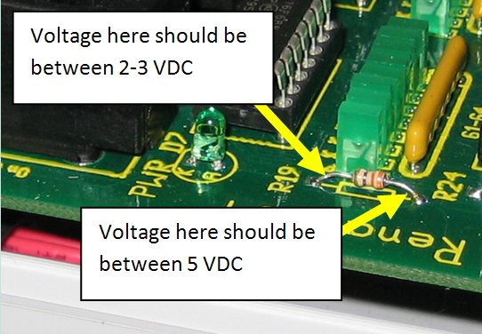

- Measure DC voltage on output side of R19. This is the end closest to the Power LED.
- If voltage is approx. 2.0-3.0 VDC, replace the LED and retest
- If voltage is approx. 5.0 VDC, then either the LED is installed backwards or it is bad
- Measure DC voltage on input side of R19. This is the end furtherest away from the Power LED.
- Voltage should be approx. 5.0 VDC.
- If correct, then double check the value of R19 and/or replace R19.
- If this is incorrect, restart the troubleshooting process.

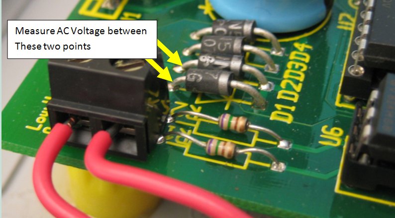

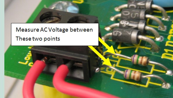

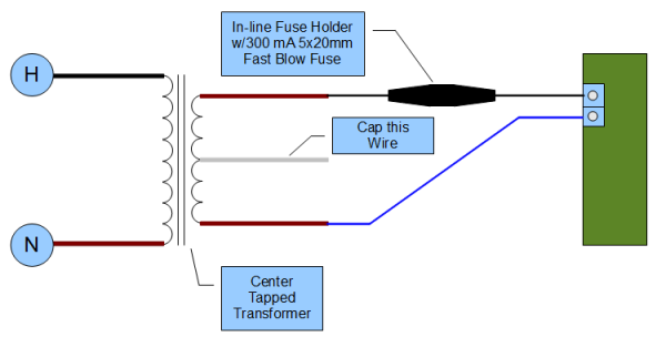

- Measure AC voltage between R1 and R2.
- Voltage should be above 6 VAC
- If correct, one or more diodes D1 thru D4 could be bad or incorrectly installed (backwards).

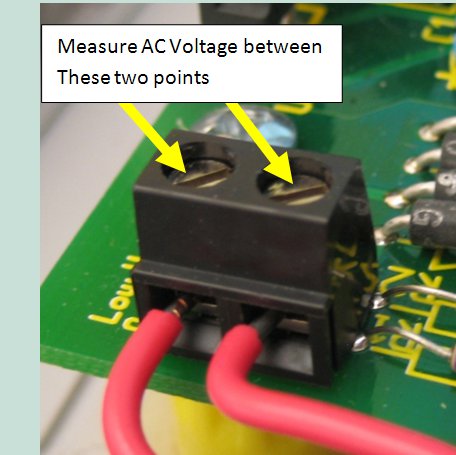

- Measure AC voltage between the power terminals Tab1 & Tab2.
- Voltage should be between 6.3VAC and 7.4VAC.
- If incorrect, transformer is probably bad or wired incorrectly.
- Measure AC voltage between the inline filter closest to the transformer and Tab1.
- If correct, the in-line fuse is probably bad.

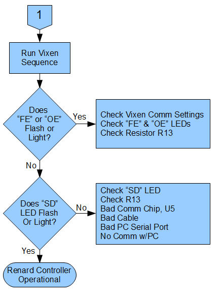

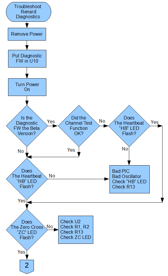

Symptom(s):
- Diagnostic LEDs do not light
- HB and ZC LED do not flash
- SD LED does not come on when receiving Vixen data
- FE and/or OE LEDs light
Possible Problem(s):
- Oscillator bad
- Zero Cross signal bad
- Zero Cross Opto installed backwards
- R1/R2 are the Wrong Value
- Bad or no data coming from Vixen
- Vixen settings incorrect
- Diagnostic LEDs bad or installed backwards
- Bussed Resistor Network installed backwards
Troubleshooting Steps
- Turn OFF AC power
- Remove PIC chip U6
- Install a PIC programmed with the Beta Renard Diagnostic Firmware into the U6 position.
- Place a shunt (jumper) on JP3
- If desired, attached lights to terminal blocks [N Ch1] thru [N Ch8]. The diagnostics can be done with only the on-board LEDs.
- Ensure that the data cable from the computer running Vixen is connected to either J2 or JDP1.
- If receiving RS232 data from the computer, place a shunt on JP1.
- Do not run any Vixen sequences until directed to do so in step 19.
- Turn ON AC power
- The Beta Renard Diagnostic Firmware should perform the following channel test:
- All channels ON for approx. 2 seconds
- All channels OFF for approx. 2 seconds
- Channel 1 turns ON for approx. 1 second then turns OFF
- Channel 2 (HB LED) turns ON for approx. 1 second then turns OFF
- Channel 3 turns ON for approx. 1 second then turns OFF
- Channel 4 turns ON for approx. 1 second then turns OFF
- Channel 5 (ZC LED) turns ON for approx. 1 second then turns OFF
- Channel 6 (SD LED) turns ON for approx. 1 second then turns OFF
- Channel 7 (FE LED) turns ON for approx. 1 second then turns OFF
- Channel 8 (OE LED) turns ON for approx. 1 second then turns OFF
- The above routine is done three times
- If no LEDs/channels came on during the above routine:
- Verify that the diagnostic LEDs are operational
- Reflash the PIC with the Beta Renard Diagnostic Firmware
- If the problem continues, then edit the Beta Renard Diagnostic Firmware to change from using the external oscillator to using the internal oscillator. If you don't know how to do this, then download this version of the Beta Renard Diagnostics Firmware.
- If the LEDs/channels are now working, then there is a problem with the oscillator U3. Check the solder pads and/or replace U3.
- If no LEDs/channels came on, then either the PIC is bad or you have no DC power to the PIC.
- If the LEDs appear dim when all are on but normal when only a single LED is lit, then it is possible that resistor network RN1 is installed backwards.
- You can choose to live with this condition but you will have to make sure that JP3 is not installed while running the operational firmware.
- If any (but not all) LEDs did not come during the step 11 routine, then go to Verifying Diagnostic LEDs
- If you used lights hooked up the channels and they did not respond correctly, then go to Troubleshooting SSR Circuitry Problems
- The Renard Diagnostic Firmware should now be blinking the HB LED (channel 2) and ZC LED (channel 5). All other channels/LEDs should be OFF.
- If the ZC LED (channel 5) is not blinking:
- Measure voltage at U6 pin 4 or U2 pin 5, should only be approximately .3 VDC. If you have an oscilloscope, you should see a signal like the purple trace in this image.
- If voltage is around 5.0 VDC , then the ZC is not working. Possible solutions:
- Replace U2
- Check the values of R1 & R2
- Check the solder pads on all the above components
- If you have gotten to this step, then your board appears to be functioning correctly so far. Now it is time to see if it will communicate with the computer.
NOTE:
Vixen only sends out data when there is a change in event data.
So make sure that the test sequence you are using has frequent changes in the event data..
- SD LED will be ON whenever Vixen sends data to the Renard SS24. The FE and OE LEDs should remain OFF.
- If this is correct, then your Renard SS24 has passed the diagnostics test.
- If the SD LED was ON and either or both the FE or OE LED came ON, then double check the Renard Dimmer plug-in settings in Vixen and retry.
- If no LEDs were lit in step 20, then it seems that you are not getting any data from the computer. Try the following:
- Make sure that your interconnect cable is built according to the Renard SS24 Controller wiki.
- Make sure that the Renard Dimmer plug-in is selected in Vixen.
- Replace U5
- Inspect the solder pads of U5 and the input data connector

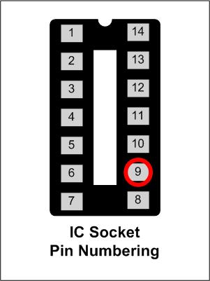

- Momentarily connect a jumper (small piece of wire) between U10 IC socket pin 13 and pin 14
- HB LED should light
- Momentarily connect a jumper between U10 IC socket pin 10 and pin 14
- ZC LED should light
- Momentarily connect a jumper between U10 IC socket pin 9 and pin 14
- SD LED should light

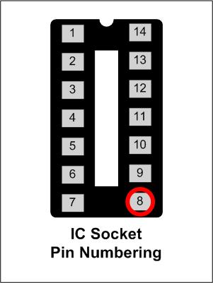

- Momentarily connect a jumper between U10 IC socket pin 8 and pin 14
- FE LED should light
- Momentarily connect a jumper between U10 IC socket pin 7 and pin 14
- OE LED should light

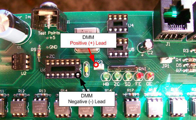

- a. Check for 5.0 VDC at U6 IC socket pin 1
- If incorrect, check the solder pads and/or go back to Troubleshooting Power Problems
- b. Check for 5.0 VDC at left side of JP3
- c. Install shunt on JP3
- d. Check for 5.0 VDC at right side of JP3 (on underside of board).
- If incorrect, replace the shunt (jumper)
- e. Check for approx. 5.0 VDC on the pins (on underside of board) of resistor network RN1.
- If correct, then probably all the LEDs are installed backwards
- If incorrect, replace RN1
