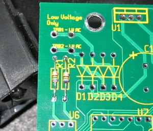

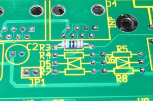

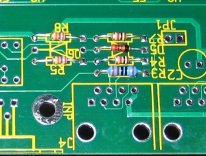

  • Install two 750 ohm resistors R1 & R2. Make sure that the resistors have a value of 750 ohms [violet/green/brown/gold]. These resistors have no polarity to worry about. The body of the resistor can be a tan color (carbon film) or blue (metal film). These are simply different types of resistor construction. It does not matter which one is used in this application. Bend the resistor leads down so that a rough "U" shaped is formed. Insert the leads into the PCB and then bend the leads out slightly from the underside of the PCB. This allows the resistor to stay fixed while soldering the leads. Solder one lead and then check to make sure that the resistor did not "slide" out or otherwise move. If it did, then re-heat that joint and reposition the resistor. Once satisfied with the placement/alignment, solder the other lead and trim the excess lead.

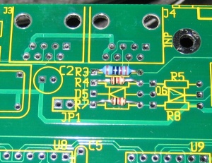

  • Install the 120 ohm resistor R3. Make sure that the resistor has a value of 120 ohms [brown/red/brown/gold]. This resistor have no polarity to worry about.
  • Install two (2) 1K ohm resistors R4 and R7. Make sure that the resistors have a value of 1K ohm [brown/black/red/gold].

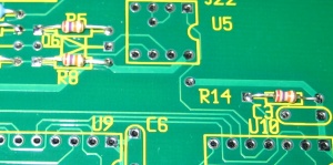

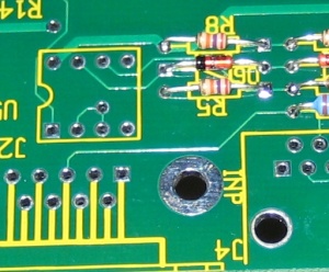

  • Install three (3) 27K ohm resistors R5, R8, and R14. Make sure that the resistors have a value of 27K ohms [red/violet/orange/gold].

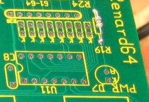

  • Install one (1) 330 ohm resistor R19. Make sure that the resistors have a value of 330 ohms [orange/orange/brown/gold].
  • Install the eight (8) 680 ohm resistors R15-18 & R24-27. Make sure that the resistors have a value of 680 ohms [blue/gray/brown/gold].
  • Install 4.3v zener diode D5. The diode must be installed correctly. The diode should have a black stripe on the orange/red body. Make sure that this stripe lines up with the stripe on the PCB silkscreen.
  • Install 9.1v zener diode D6. The diode must be installed correctly. The diode should have a black stripe on the orange/red body. Make sure that this stripe lines up with the stripe on the PCB silkscreen.

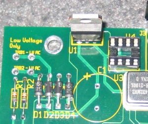

  • Install four diodes D1 thru D4. The diodes will have a silver/grey stripe on a black body. Make sure that this stripe lines up with the stripe on the PCB silk screen. The diodes should be formed like the resistors above. Insert them into the holes and bend back the leads slightly to hold them in place. Solder and trim the leads like the resistors.

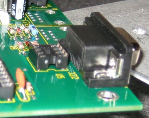

Also, for the sockets, Pin 1 must be aligned with the square solder pad. Another way to verify that you installed them correctly is to make sure that the notch on the socket is aligned with the notch on the PCB silkscreen outline.
  • Install one (1) 6-pin IC socket for U6. This part is not included in the original Renard 64XC BOM. However, it is strongly suggested that you use sockets for this IC chip so it is included in the latest BOM. Insert the socket as per the silkscreen. Solder pin #1 and check the component for "slippage". Once the component placement is confirmed, solder the other 5 pins. This item does not require trimming. Please note that the picture has the socket backwards. This can happen to the best of assemblers. It does not REQUIRE removal and repositioning as long as the chip is installed in the correct orientation. The best solution is to mark the socket with a dot of color (fingernail polish works well) on the socket as a reminder to check the chip placement.
  • Install two (2) 8-pin IC sockets for U4 & U5. These parts are not included in the original Renard 64XC BOM. However, it is strongly suggested that you use sockets for these IC chips so they are included in the latest BOM. Insert the sockets as per the silkscreen. Solder pin #1 and check the component for "slippage". Once the component placement is confirmed, solder the other 7 pins for each socket. These items do not require trimming.

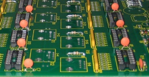

  • Install eight (8) 14-pin IC sockets for U7-U14. Insert the sockets as per the silkscreen. Solder pin #1 and check the component for "slippage". Once the component placement is confirmed, solder the other 13 pins for each socket. These items do not require trimming.

  • Install eight (8) 0.1uF capacitors C3-C10. These capacitors are not polarized so the orientation is not critical. The capacitor leads are already formed. However, sometimes they do not match the PCB holes exactly. Bend the leads as required to insert them into the PCB holes. Then, bend the leads back slightly to hold the capacitor in place. Solder and trim the leads the same as the resistors.

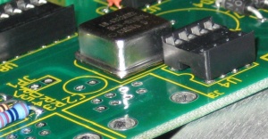

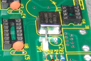

  • Install the clock oscillator U3. The oscillator must be installed in the correct orientation. The oscillator has three rounded corners and one squared corner. Make sure that the squared corner is positioned to match the PCB silkscreen. Solder Pin #1, and then verify that the component placement matches the silkscreen and that the component has not "slipped" out of the hole. Once verified, solder the the remaining pins. Trim the excess leads as you would with a resistor or diode.
  • Install sixty four (64) Green Channel LEDs. The LEDs are polarized and must be installed correctly. The long lead is the anode and must be placed in the square solder pad. The short lead is the cathode and this is marked on the silkscreen with a "K". Now, the question seems to come up a lot.."how do I get these straight?". Since the LEDs are rectangular, it is VERY noticeable if they are not. The best answer is to put them into the board and bend the leads back slightly as you would do for any other passive component. Then, put a piece of tape across the LEDs to hold them in place. Solder one lead on each LED and remove the tape. Now, you can reheat each single LED lead and make adjustments to line them up. Once you are satisfied, solder the other lead and trim the excess. The bottom edge of these rectangular LEDs is not smooth or uniform. So, if you want "perfect" alignment, be prepared to "lift" a few of the LEDs a bit to get them flush with their neighbors.

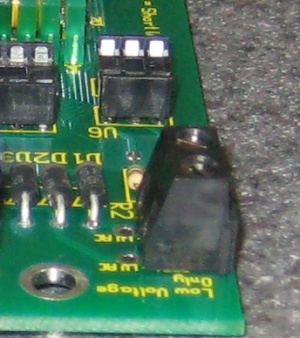

  • The original Renard 64XC BOM calls for spades here. However, many users prefer to use a single 2 position terminal here. Install one (1) two position terminal block for 6.3VAC input.

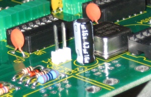

  • Install one (1) 2-pin vertical header JP1. These headers are not polarized so the orientation is not important. Once again, a small piece of tape works well to hold the header in place. Solder one lead, check for alignment, then solder the opposite lead. No trimming is required for this component.
  • Install the 47uF capacitor C2. This capacitor is polarized and must be installed correctly. The capacitor should have a silver/grey stripe on the body to indicate which lead is negative. The positive lead of the capacitor will be the longer lead. Make sure that the positive lead is placed in the square solder pad. Then, bend the leads back slightly to hold the capacitor in place. Solder and trim the leads the same as the other passives.
  • OPTIONAL: Install the DE9 connector J22. This connector is only needed if you plan on using a normal serial cable to connect to the first board in the chain. You can, however, make a DE9 x RJ45 cable instead. For boards after the first one on the PC COMM port, this connector is not needed.

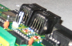

  • Install two (2) RJ45 modular jacks J3 and J4. Due to minor variations in manufacturing, some RJ45 jacks are a tighter fit than others. Care should be taken to ensure that the pins are aligned first before applying too much pressure to seat the locking lugs through the board.
  • Install sixteen (16) RJ45 Top Entry modular jacks J5-J16 and J18-J21. Due to minor variations in manufacturing, some RJ45 jacks are a tighter fit than others. Care should be taken to ensure that the pins are aligned first before applying too much pressure to seat the locking lugs through the board.
  • Install the voltage regulator U1. The voltage regulator must be installed correctly. The voltage regulator's tab/heat sink must be aligned with wider line of the PCB silkscreen outline (facing outwards to the PCB edge). Insert the component and then flip the board over. Solder one pin...then flip the board back over and check for alignment. Simply reheat the joint and position the regulator so that it is square to the board. Solder the other two leads and trim off the excess.

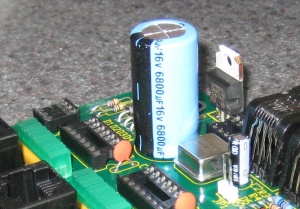

  • Install the 6800uF capacitor C1. This capacitor is polarized and must be installed correctly. The capacitor should have a black stripe on the body to indicate the negative lead. The positive lead of the capacitor will be the longer lead. Make sure that the positive lead is placed in the square solder pad. Then, bend the leads back slightly to hold the capacitor in place. Solder and trim the leads the same as the other passives.
