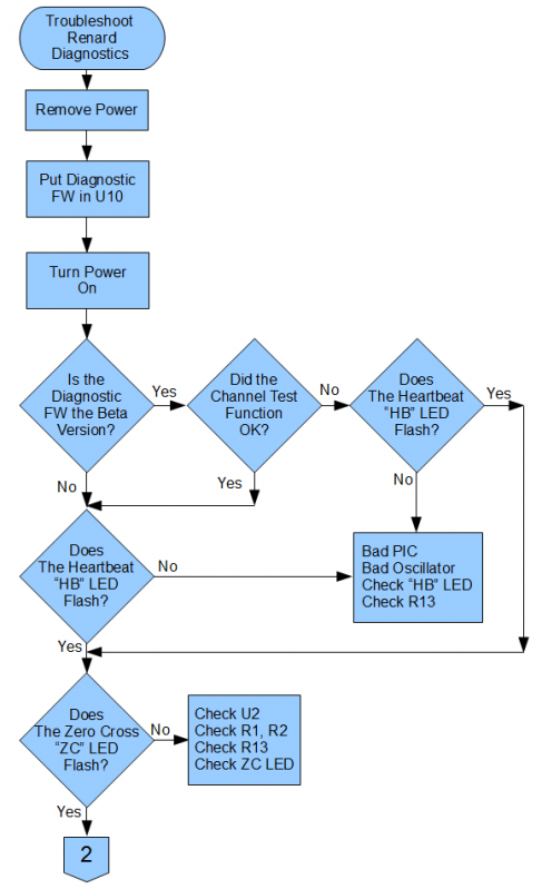

Troubleshooting Diagnostics Problems
Symptom(s):
- Diagnostic LEDs do not light
- HB and ZC LED do not flash
- SD LED does not come on when receiving Vixen data
- FE and/or OE LEDs light
Possible Problem(s):
- Oscillator bad
- Zero Cross signal bad
- Bad or no data coming from Vixen
- Vixen settings incorrect
- Diagnostic LEDs bad or installed backwards
- PIC bad
Troubleshooting Flow
Troubleshooting Steps
- Turn OFF AC power
- Remove PIC chip U6
- Install a PIC programmed with the Beta Renard Diagnostic Firmware into the U6 position.
- Place a shunt (jumper) on JP3
- If desired, attached lights to terminal blocks [N Ch1] thru [N Ch8]. The diagnostics can be done with only the on-board LEDs.
- Ensure that the data cable from the computer running Vixen is connected to either J2 or JDP1.
- If receiving RS232 data from the computer, place a shunt on JP1.
- Do not run any Vixen sequences until directed to do so in step 19.
- Turn ON AC power
- PWR LED should be lit
- If incorrect , then go to Troubleshooting Power Problems.
- The Beta Renard Diagnostic Firmware should perform the following channel test:
- All channels ON for approx. 2 seconds
- All channels OFF for approx. 2 seconds
- Channel 1 turns ON for approx. 1 second then turns OFF
- Channel 2 (HB LED) turns ON for approx. 1 second then turns OFF
- Channel 3 turns ON for approx. 1 second then turns OFF
- Channel 4 turns ON for approx. 1 second then turns OFF
- Channel 5 (ZC LED) turns ON for approx. 1 second then turns OFF
- Channel 6 (SD LED) turns ON for approx. 1 second then turns OFF
- Channel 7 (FE LED) turns ON for approx. 1 second then turns OFF
- Channel 8 (OE LED) turns ON for approx. 1 second then turns OFF
- The above routine is done three times
- If no LEDs/channels came on during the above routine:
- Verify that the diagnostic LEDs are operational
- Reflash the PIC with the Beta Renard Diagnostic Firmware
- If the problem continues, then edit the Beta Renard Diagnostic Firmware to change from using the external oscillator to using the internal oscillator. If you don't know how to do this, then download this version of the Beta Renard Diagnostics Firmware.
- If the LEDs/channels are now working, then there is a problem with the oscillator U3. Check the solder pads and/or replace U3.
- If no LEDs/channels came on, then either the PIC is bad or you have no DC power to the PIC.
- If the LEDs appear dim when all are on but normal when only a single LED is lit, then it is possible that resistor network RN1 is installed backwards.
- You can choose to live with this condition but you will have to make sure that JP3 is not installed while running the operational firmware.
- If any (but not all) LEDs did not come during the step 11 routine, then go to Verifying Diagnostic LEDs
- If you used lights hooked up the channels and they did not respond correctly, then go to Troubleshooting SSR Circuitry Problems
- The Renard Diagnostic Firmware should now be blinking the HB LED (channel 2) and ZC LED (channel 5). All other channels/LEDs should be OFF.
- If the ZC LED (channel 5) is not blinking:
- Measure voltage at U6 pin 4 or U2 pin 5, should only be approximately .3 VDC. If you have an oscilloscope, you should see a signal like the purple trace in this image.
- If voltage is around 5.0 VDC , then the ZC is not working. Possible solutions:
- Replace U2
- Check the values of R1 & R2
- Check the solder pads on all the above components
- If you have gotten to this step, then your board appears to be functioning correctly so far. Now it is time to see if it will communicate with the computer.
