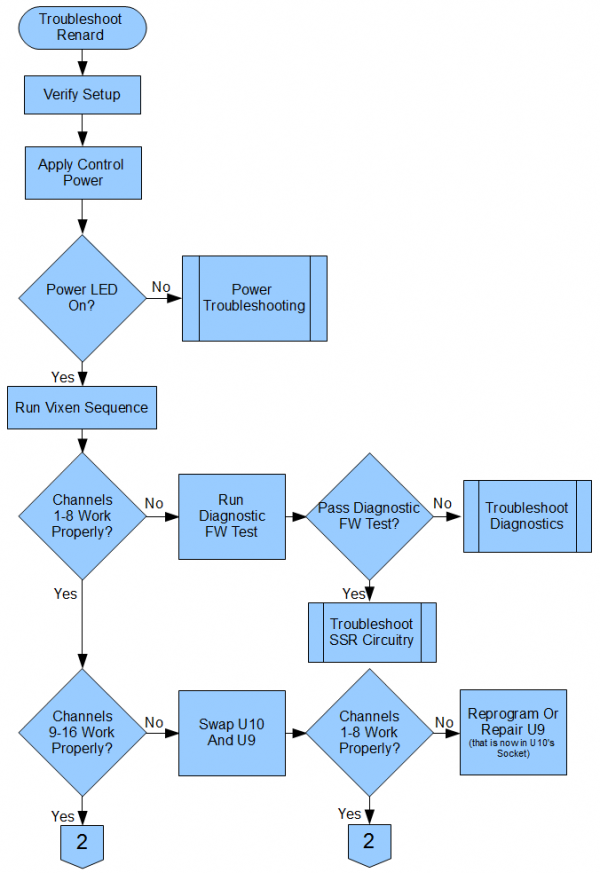

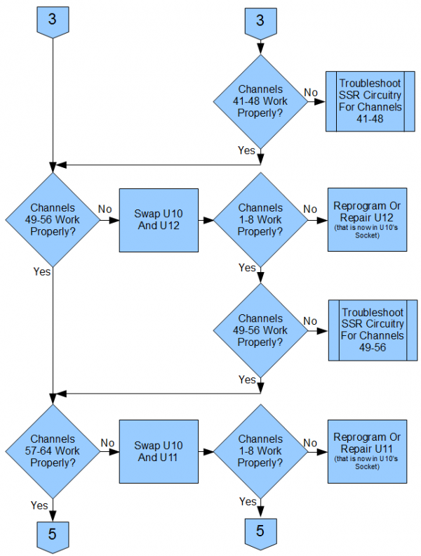

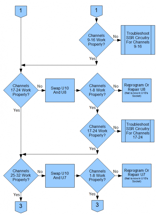

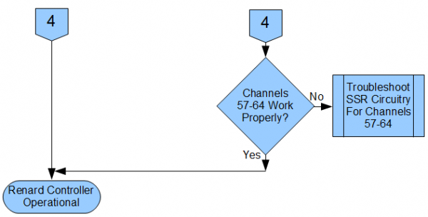

Troubleshooting the Renard 64XC Controller
Troubleshooting Flow
Troubleshooting Steps
  1. Verify that you have the power/control cables connected correctly as compared to the Renard 64XC Controller wiki.
  2. Verify that you have the Vixen plug-in settings correct as compared to the Renard 64XC Controller wiki.
  3. For the following steps, the PICs (U7 thru U14) need to be programmed with the Renard Operational Firmware.
  4. Turn ON AC power
  5. PWR LED should be lit
  6. Run a Vixen sequence
  7. Do Channels 1 thru 8 respond as programmed in the Vixen sequence?
  8. Do Channels 9 thru 16 respond as programmed in the Vixen sequence?
    • If they do, go to step 15
  9. Turn OFF AC power
  10. Swap PIC chips U10 and U9
  11. Turn ON AC power
  12. Run the Vixen sequence again
  13. Do Channels 1 thru 8 respond as programmed in the Vixen sequence?
    • If they don't, reprogram or replace the U9 PIC chip that you moved to the U10 socket and retest
  14. Do Channels 9 thru 16 respond as programmed in the Vixen sequence?
  15. Do Channels 17 thru 24 respond as programmed in the Vixen sequence?
    • If they do, then goto step XX.
  16. Turn OFF AC power
  17. Swap PIC chips U10 and U8
  18. Turn ON AC power
  19. Run the Vixen sequence again
  20. Do Channels 1 thru 8 respond as programmed in the Vixen sequence?
    • If they don't, reprogram or replace the U8 PIC chip that you moved to the U10 socket and retest
  21. Do Channels 9 thru 16 respond as programmed in the Vixen sequence?
    • If they don’t, replace PIC chip U6 and retest
  22. Do Channels 17 thru 24 respond as programmed in the Vixen sequence?
