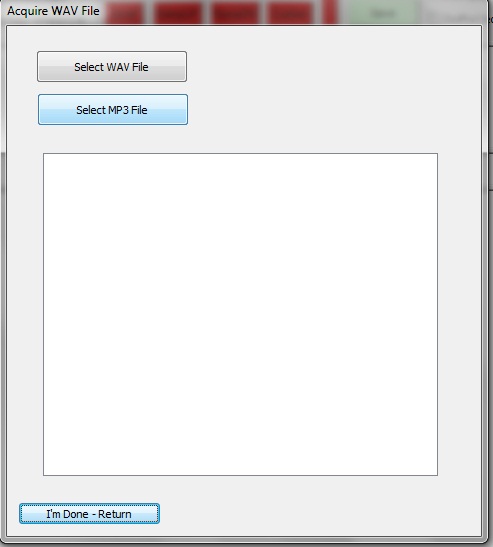

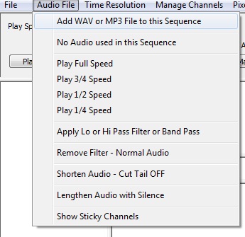

- As with any sequence, first, an audio file must be loaded in either wav or mp3 format.
- Next the sequence name must be identified. Click OK. Then save the sequence in the suggested folder hierarchy:

- Select the Wav or MP3 file and then select "I'm Done, Return." Once it has processed, a notification window will appear stating the save is complete. Click OK to return to the main HLS window.

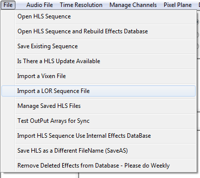

- Click File, Import a LOR Sequence File. Then navigate and select the appropriate LOR sequence for the audio just added to the HLS sequence. Also select the HLS sequence that was created. It will ask to overwrite. Select Yes. Once OK has been clicked, the conversion will begin.
- Next will be a prompt to select a sequence timing interval. It may be helpful to match the timing interval of the sequence being imported.
- A counter will show the status of the channel import process. Once complete, notification will be provided of the channels successfully converted into HLS. A prompt will appear to shutdown HLS to convert RGB channels (if any are present).
