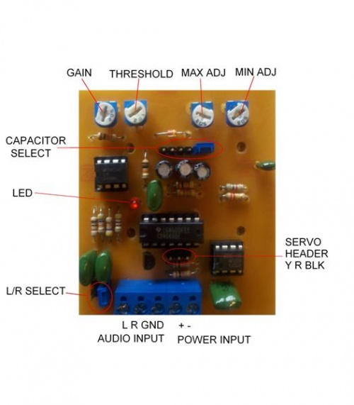

Adjustments
Gain: R3 The gain adjustment is used to control the gain of the amplifier to match the controller to your source audio
Threshold: R6 The threshold adjustment is used to calibrate the circuit and set the point of sound or no sound
Max Adj: R22 The max adjust is used to set the maximum servo position when sound is present. You can think of this like a high limit switch
Min Adj: R10 The min adjust is used to set the minimum servo position when sound is not present. You can think of this like a low limit switch.
Capacitor Select: JP4,JP5,JP6 There are 3 capacitors of different values to chose from. The higher the value of the capacitor the more smooth the jaw will move. If you want a more jerky action enable a lower value capacitor or no capacitor at all. The capacitors are arranged lowest to highest value from left to right. Capacitors are enabled by placing a shunt on the jumpers JP4,JP5,JP6 directly above the capacitors.
LED: The LED lights up when sound is present and is used to aid in setting the threshold adjustment
L/R Select: JP1,JP2 If you want the board to "Listen" only to the left or right channel of audio install a shunt on either the left or right jumper. If you want it to "listen" to both channels install shunts on both jumpers.
Connections
Audio input: X3 This is where you connect stereo audio to the board. anything from line level to low level speaker should be OK
Power input: X2 4.7-6 VDC is connected here. The current required will depend largely on the servo you are using. This circuit draws very little current check the specs your servo for current requirements
Servo Header: JP3 This is where your servo will connect to the board. Pin#1(yellow) goes to the left when connecting the servo
Setup
1 Turn on the power and remove all audio source. This can be done by removing the L/R select shunts
2 Turn the threshold adjustment clockwise until the circuit trips(the LED will light and the servo will move to the open position)
3 Adjust the MAX adjust to your desired full open position.
4 Slowly turn the threshold adjustment counter-clockwise until the circuit resets(LED will turn off and servo will move to the closed position)
5 Adjust the Min adjustment to your desired full closed position.
6 Add your audio source and adjust the gain as needed to make the circuit trip and reset with the audio

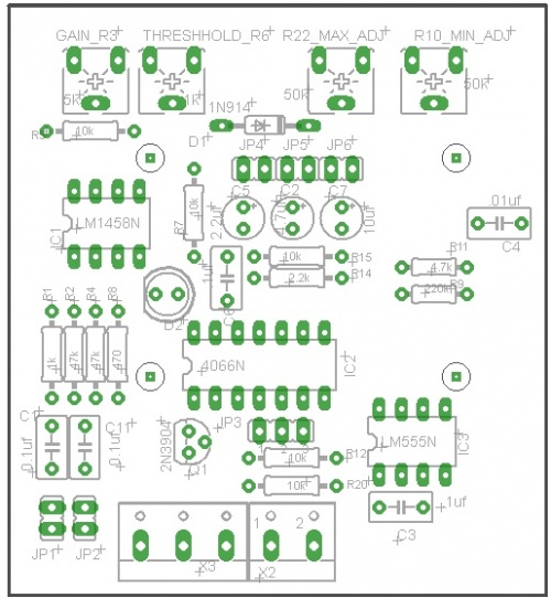

Assembly
THE ASSEMBLY INSTRUCTIONS ARE A WORK IN PROGRESS, PLEASE CHECK BACK IN A FEW DAYS WHEN IT IS FINALLY CORRECT
The Simple Sound to Servo is a simple device to assemble and test. It is easiest if you build the units by inserting the various components from smallest to tallest .
- Begin by inspecting the PCBs to look for any defects such as cracks or breaks. The holes on the board should be open on both sides. Then inspect and sort out the various parts for the board.
 - Install the resistors:
- Install the 220K ohm resistor (red-red-yellow) at location R9. The resistor is not polarized, so it can go either way.
 - Install the 1K ohm resistor (brown-black-red) at location R1. The resistor is not polarized, so it can go either way.
 - Install the 47K ohm resistors (yellow-violet-orange) at locations R2 and R4. The resistors are not polarized, so it can go either way.
 - Install the 10K ohm resistors (brown-black-orange) at locations R5,R12,R15,R20. The resistors are not polarized, so it can go either way.
 - Install the 2.2K ohm resistor (red-red-red) at location R14. The resistor is not polarized, so it can go either way.
 - Install the 470 ohm resistor (yellow-violet-brown) at location R8. The resistor is not polarized, so it can go either way.
 - Install the 4.7K ohm resistors (yellow-violet-red) at locations R4 and R11. The resistors are not polarized, so it can go either way.
 - Install adjustment trimpots:
- Install the 5K ohm trimpot at location R3. The trimpot only fits one way, with the two legs towards the top of the board.
 - Install the 1K ohm trimpot at location R6. The trimpot only fits one way, with the two legs towards the top of the board.
 - Install the 50K ohm trimpots at locations R10 and R22. The trimpot only fits one way, with the two legs towards the top of the board.
 - Install the IC sockets:
- Install the 14 pin IC socket at location IC2. The notch on the socket should face the left side of the board.
 - Install the 8 pin IC sockets at locations IC1 and IC3. The notch on the socket should face the left side of the board.
 - Install the 1N914 Diode at location D1. The diode is polarized and it can only go one way. The end with the band (cathode) goes towards the right side of the board.
 - Install the 2N3904 transistor at location Q1. The flat side of the transistor should face the left side of the board.
 - Install the capacitors:
- Install the 2.2uF electrolytic capacitor at location C5. The capacitor is polarized. The side of the capacitor will have a stripe on the negative side. The long lead is the positive side, and it goes in the hole towards the top side of the board.
 - Install the 4.7uF electrolytic capacitor at location C2. The capacitor is polarized. The side of the capacitor will have a stripe on the negative side. The long lead is the positive side, and it goes in the hole towards the top side of the board.
 - Install the 10uF electrolytic capacitor at location C7. The capacitor is polarized. The side of the capacitor will have a stripe on the negative side. The long lead is the positive side, and it goes in the hole towards the top side of the board.
 - Install the 100nF (0.1uF) mylar capacitors at locations C1,C3,C6,C11. The capacitor is not polarized, so it can go either way.
 - Install the 10nF (0.01uF) mylar capacitor at location C4. The capacitor is not polarized, so it can go either way.
 - Install the red LED at location D2. The LED is polarized. There is a flat side (cathode) has a short lead and it faces towards the left side of the board.
 - Install the jumpers:
- Install the 2 pin headers at locations JP1 and JP2. Snap the 2pin header from the longer strip by holding it in pliers and breaking along the lines between the pins. The short side of the jumper strip goes into the board.
 - Install the 3 pin header at location JP3. Snap the 3pin header from the longer strip by holding it in pliers and breaking along the lines between the pins. The short side of the jumper strip goes into the board.
 - Install the 6 pin header across locations JP4,JP5,JP6. Snap the 6pin header from the longer strip by holding it in pliers and breaking along the lines between the pins. The short side of the jumper strip goes into the board.
 - Install the Screw connectors:
- Install the 3 position screw terminal block at location X3. The side where the wires enter under the screw should face the bottom of the board.
 - Install the 2 position screw terminal block at location X2. The side where the wires enter under the screw should face the bottom of the board.
 - Install the ICs:
- Install the LM1458N IC in the 8 pin socket at location IC1. The notch on the IC should face the left side of the board.
 - Install the CD4066 IC in the 14 pin socket at location IC2. The notch on the IC should face the left side of the board.
 - Install the NE555 IC in 8 pin socket at location IC3. The notch on the IC should face the left side of the board.
Congratulations, you have just finished building the Simple Sound to Servo! Inspect the board to make sure that you have soldered all connections and that there are no shorts or cold solder joints.
