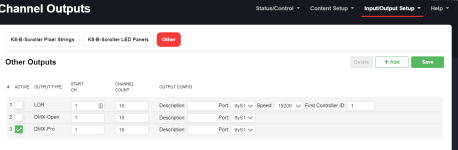

Is there a trick to connect a LOR device to a Kulp K8-B Scroller? I have been able to make it work using the RJ45 jack on a F8-B, but on the K8-B scroller, we use the header pins, but I can't seem to activate the port. The LOR device LED continues to flash, whereas when connected to the F8-B it goes solid. I wired Green to G, Blue to + and Blue Stripe to - and connected it to the ttyS1 header. On the "Other Outputs" tab, I've tried creating an active output (Tried both LOR and DMX-open) for all ports ttyS0 to ttyS5, this is a new board and I'm wondering if something needs to be done to "activate" the DMX/LOR ports on the Uart? The FPP configs are slightly different than a K8-B because of the Panel output, but I don't have a K8-B to test with (yet).

Yes, the LOR device continues to flash on the scroller, but went solid on the F8-B when it was properly configured. I'm sending data via the "Display Testing: option under the Status/Control tab. Pixels work fine. I don't see the "always transmit channel data" option under any of the Channel Outputs tabs.. The LOR Controller I'm using has some jumpers for LOR/DMX. I leave them on LOR when using the RJ45 connector on the F8-B, but on the scroller, I'm not sure if I should be using the DMX jumper settings instead - I've tried both. Also note, on the F8-B I have nothing set up on the "Other" tab under Channel Outputs, but I do have the Serial Mode set to DMX on the F8-B tab. The Scroller has no string settings on the K8-B Scroller Pixel Strings tab, but I believe I do have to set up the LOR Controller on the "Other" tab. And here, I've tried both LOR and DMX-Opon and DMX-Pro - see image.1708213375842.png
Unselect the DMX-Pro and then delete both the DMX-Open and DMX-Pro output types. Just keep the LOR output type.
Check the LOR box to make it active, verify the port (ttyS1 or ttyS2, which ever you’re using) and all the other settings for LOR, then select Save.

I've tried everything as you suggested. Advanced Level, Always transmit channel data. And Output Type is LOR I've also gone into XL, built a simple layout and sequence. The Pixel output works fine, but still no luck to the LOR. I'm still hung up on the LED - do you know if it should be steady when connected to the scroller. When connected to a dongle or even the F8-B, the LED is steady. Also, on the controller there are jumpers for LOR/DMX. So far, everything has been set to LOR (when working with the F8-B), should it be changed to DMX when connected to the Scroller? I think this is where my issue is, but I have tried both.
