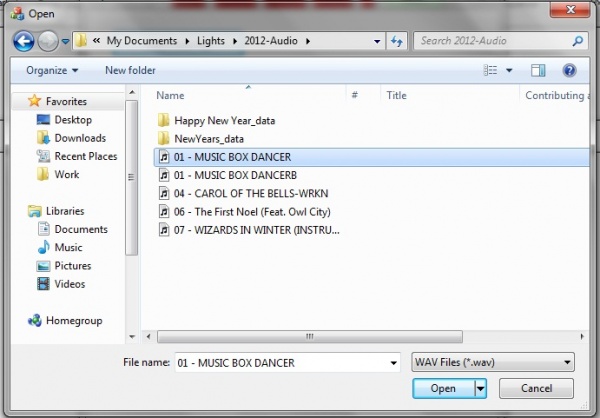

Next select either a WAV or mp3  file. In this example Music Box Dancer WAV will be chosen (see Figure 1-3).
After you have chosen the WAV file,  the screen shown in Figure 1-4 will appear.
