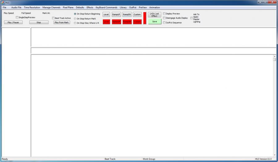

Open HLS. You should see a screen like the one shown in Figure 1-1. Note that when you open HLS you are already creating a new sequence. You may only have one sequence open at a time. So if you are working on one and want to start another one, save your current sequence, shut HLS down and then restart HLS and work on the new sequence.
Figure 1-1

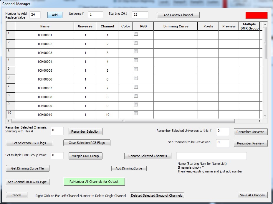

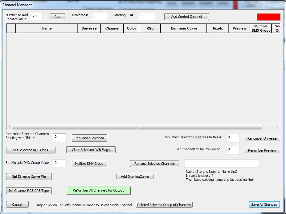

The Channel Manager screen will now as appear (see Figure 1-6). This is where we will add and configure channel outputs. For this example we will use a Renard 16 and a Renard 8 module. This would be 24 outputs total. We do not have to tell the software we have two controllers in this example as they are both Renards and they will both be attached to the same com port.
Enter "24 for your 24 (16 +8) outputs in the window to the right of # channels to add then click the "Add" button.
A "Channel Name" window will now open like Figure 1-7.1. The channel names will be created with whatever you enter here with
"_0000", "_0001", etc appended to the end of it. In the example "Ch" was entered in this window and you can see the results in Figure 1.7
Next, change the Universe # entry. It cannot be zero for real outputs. In this example we will only have one type of controller and one port so we will only use one universe. 1 was entered for this example. Next, the starting channel entry was changed to 1 to correspond to the first channel (output) in a Renard being 1.
Once these three changes have been made, click on the Add button to actually add the new channels. See figure 1.7
Figure 1-8 shows the screen after the outputs have been added.
