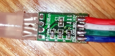

WS2801
WS2801 Pixel Strings (input is chip side)
Scheme +5V 0V Clock Data Photo
1 Red Blue Green White
Sources:
  1. tjetzer
