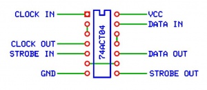

  3. Check voltage at U1 pin 2 (Data In).
    • Should be approximately 2.75-4.0 VDC for two seconds and then 0 VDC for two seconds and repeat continuously.
  4. Check voltage at U1 pin 3 (Clock).
    • Should see a fluctuating voltage of approximately 0.05-0.10 VDC.
  5. Check voltage at U1 pin 4 (Strobe).
    • Should see a voltage barely fluctuating above ground potential.

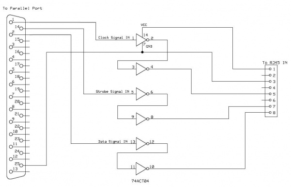

    • Check voltage at parallel port pin 2.
      If incorrect:
      1. Double check Vixen plugin settings
      2. Change parallel port settings in computer BIOS and re-run troubleshooting steps.
      3. If these steps didn't solve the problem then it is possible that the parallel port is bad or incompatable with Vixen. Try a different computer.
      If correct:
      Check the data cable wiring as compared to The GRINCH Controller wiki.

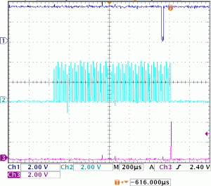

Using an Oscilloscope
  1. Ensure that the data cable is connected
    • This testing can be done with power applied or not, it is up to you.
  2. Run the Vixen test sequence.
    • Remember to click the Loop icon so the sequence will run continuously.
  3. Monitor signal at U1 pin 2 (Data In).
    • Should be similar to the dark blue trace in the image. Should be alternating between a High and a Low every two seconds.
  4. Monitor signal at U1 pin 3 (Clock).
    • Should be similar to the light blue trace in the image. There should be a total of 64 pulses.
  5. Monitor signal at U1 pin 4 (Strobe).
    • Should be similar to the violet trace in the image. There should be just one pulse occurring after the 64 clock pulses.
  6. If signals in step 3 thru 5 are good.
    • You are receiving good Vixen data from the parallel port.
  7. If signals in step 3 thru 5 are there but just not on the correct pins.
  8. If signals in step 3 thru 5 are only 0 VDC or 5 VDC or are not similar to the image.
    • Check signal at parallel port pin 2.

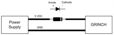

  9. Measure voltage at U1 pin 24 (VCC).
  10. If voltage in step 9 is above 3.0 VDC (Allegro chips) or above 4.5 VDC (MBI chips)
    • The following steps will lower the operating voltage to the Grinch. If you have another method of lowering the voltage you can skip the following steps.
      1. Stop the Vixen sequence
      2. Remove power from the Grinch
      3. Place a 1N4001 diode (or equivalent) in-line with the Grinch input power
        This should drop the VCC voltage by approximately 0.5 - 0.7 VDC. For more info on how lowering the input power affects the Grinch can be found in The GRINCH Controller wiki.
      4. Go back to the beginning of these troubleshooting steps
