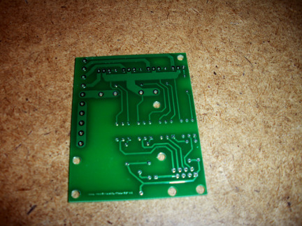

PLEASE NOTE: THE OVERLAY FOR THE TRIACS IS INCORRECT FOR Version 1.3. THE TAB SHOULD FACE THE BOTTOM OF THE BOARD, NOT THE TOP. Rev 1.3a is correct and is now shipping

- Now its time for the the TRIACs. These pins are large and they can be difficult to solder at first. If you have problems...tin the leads prior to inserting them into the boards. Solder the pins in place and trim the excess. NOTE for Ver 1.3!!! : THE SILKSCREEN FOR THE TRIACS IS INCORRECT. THE TAB SHOULD FACE THE BOTTOM OF THE BOARD (THE RJ45 Side), NOT THE TOP. Version 1.3a has the corrected Silkscreen

Early Prototype Picture
I have left this image, only to record that the version 1.3 and prototype boards have the silkscreen overlay for the TRIACs reversed.
