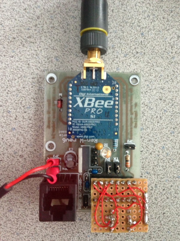

Ren-W Receiver connected to RS485

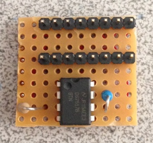

A DS75176 is used as a RS485 transmitter.
- Remove Max232IN on the Ren-W
- Make sure JP2 is NOT jumpered on the Ren-W
- Jumper TX and RX on the Ren-W
- On the Ren-W, solder pins 7/8 on the RJ45 together, and connect to 5V on the board.

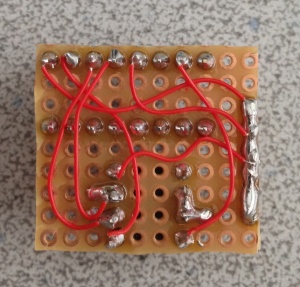

- On the DS75176 connect:
- Pin 2 to Pin 3 and connect that via a 4.7K resistor to 5V
- Pin 4 to Pin 10 on the Max232 pinout (note MAX232 is removed) on the Ren-W
- Pin 5 to 0V
- Pin 6 to Pin 7 with a 120 Ohm resistor
- Pin 8 to 5V
- Also connect Pin 6 to the bottom of the RX header on the Ren-W (bottom is nearest the LED)
- Also connect Pin 7 to the bottom of the TX header on the Ren-W (bottom is nearest the LED)
- Connect Pin 12 on the Max 232 pinout (not MAX232 is removed) on the Ren-W to 5V
- Supply 0V to JP4, supply 5V to JP3
Another way to implement the receiver changes is to create a daughter board that plugs into the MAX232 DIL socket:
