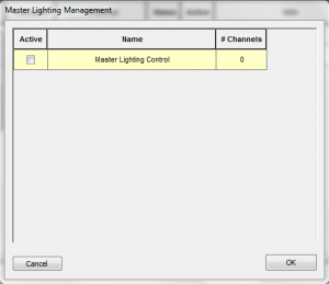

  • A window will open listing any master/submaster lighting channels (see Figure 9-13).
  • If you wish these lighting channels to be applied to the export, click the Active box.

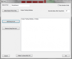

Figure 9-15
  • Close down and reopen HLS without opening a sequence.
  • To create your playlist, click Output -> Create a Playlist.
  • The Playlist Window will open (see Figure 9-15).
  • Type in a name for your new playlist.
Figure 9-16
  • Click Select Export File to Play.
  • This will list all of the sequences with exported illumination data (see Figure 9-16).
  • Select the desired file and click ok.
  • The selected file will now be listed next to the Export button (see Figure 9-15).
  • Adjust the Seconds Delay after Song Ends field to the desired time delay.
  • Click Add Song to List to add the song to your playlist with the specified delay.
  • Continue doing this until all songs are added to your playlist.
    • If you wish the songs to play randomly, click the Random checkbox.
  • When complete, click OK.

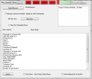

Playing a Selected Playlist
Figure 9-17
  • To play a selected playlist, click Output -> Play Specific Playlist (see Figure 9-17).
    • Note: You cannot have a sequence open to perform this action.
  • Click Select Playlist and select the desired playlist.
  • Select Play Now and click the Play Now button.
