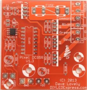

=PCB= | |||
[[File:PixelDCSSR1-3.jpg|300px]]<br/> | |||
The PCB is available at [http://www.diyledexpress.com/ DIYLEDExpress.com] | |||
