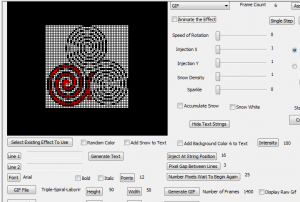

Animated GIFs
A GIF effect generates an animated GIF file that is displayed on the PixelPlane Object.
- Use With: MegaTree, Vertical Matrix.
Options to Customize a GIF Effect:
- Speed of Rotation: How fast the GIF should move between frames.
 - Injection X, Y: Coordinates of where you want the image to be generated (Top-left would be 1,1).
 - Sparkle: Add random sparkling to the GIF.
Selecting the GIF:
- Click the GIF File button and open your desired GIF file.
 - Click the Height and Width buttons to let HLS know the dimensions to use when drawing the file on the PixelPlane Object.
 - Click the Generate GIF button to complete setting up the file. Any changes to the file will require pressing the Generate GIF button again.
 - HLS will output the number of animation frames included in the GIF file.
 - Display Raw GIF will display the actual animated GIF file rather than the generated animation as it will appear in your PixelPlane Object.
