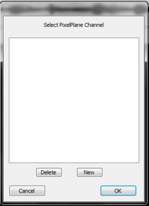

*In the ''Select PixelPlane Channel'' window, press the NEW button to create a new PixelPlane (See Figure 6-1).

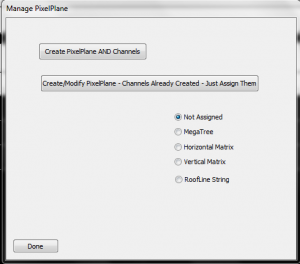

*The ''Manage PixelPlane'' window will open (See Figure 6-2). Click '''Create PixelPlane AND Channels.'''
*'''Note:''' In the past, PixelPlane Channels were first created in the regular Channel Manager. They are now created here. If you have already created channels (in the old way), or are importing from another file and want to convert channels to a pixel plane, select ''Create/Modify'' and select your channels manually and then save the changes.

  • First, open the PixelPlane Manager (Manage Channels -> Manage PixelPlane Channels).
  • In the Select PixelPlane Channel window, press the NEW button to create a new PixelPlane (See Figure 6-1).
  • The Manage PixelPlane window will open (See Figure 6-2). Click Create PixelPlane AND Channels.
  • Note: In the past, PixelPlane Channels were first created in the regular Channel Manager. They are now created here. If you have already created channels (in the old way), or are importing from another file and want to convert channels to a pixel plane, select Create/Modify and select your channels manually and then save the changes.
