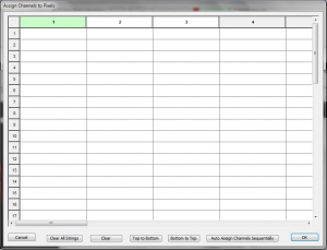

Assigning Channels to Pixels
Figure 6-13
  • HLS needs to understand how your pixels are arranged on your PixelPlane object to be able to correctly assign pixels to positions. To do this, HLS has an Assign Channels to Pixels button in the PixelPlane Editor.
  • Click the Assign Channels to Pixels button from the PixelPlane Editor.
  • Figure 6-13 will appear.
  • This grid contains the layout of your PixelPlane object. The Columns represent the strands of pixels, and the rows represent the pixels in each strand. This is defined when you setup your PixelPlane object.
  • Note: Notice that the first column is green. Left-click on the first column header to select it. You must do this before any channel assignment can take place.
  • The buttons at the bottom serve specific purposes:
    • Cancel: Cancels the Pixel Assignment window.
    • Clear All Strings: Clears any previously set strand assignment.
    • Clear: Clears a specific string.
    • Top to Bottom: Means your strings are arranged with the first pixel at top and last pixel at bottom.
    • Bottom to Top: Means your strings are arranged with the first pixel at bottom and last pixel at top.
    • Auto Assign Channels Sequentially: Once the first string is assigned, this will complete the rest of the string assignment.
    • OK: Save changes and close.

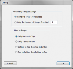

  • To Auto Assign Channels, first, make sure the header for string 1 is selected (it will be green).
  • Click Auto Assign Channels Sequentially.
  • Figure 6-14 will appear.
  • Choose whether to complete the whole tree, or, if using less than a full tree, fill in the number of strings you will be using.
  • Choose how your pixels will be physically arranged on the object.
  • Click OK.

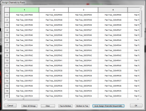

  • The Channel Assignment grid will once again appear (See Figure 6-16).
  • Channels will now be auto-assigned based on your settings.
  • Click OK to complete assignment.

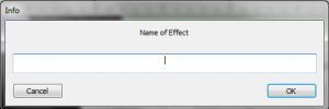

Naming the PixelPlane Effect
Figure 6-17
  • PixelPlane effects must be named before they can be generated into a sequence.
  • To name your PixelPlane effect, click the Name of This Effect button.
  • Figure 6-17 will appear.
  • Type in the name of your effect and hit OK. The assigned name will update to the new name.

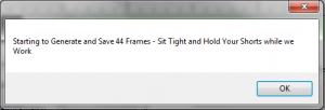

Generating the PixelPlane Effect
Figure 6-18
  • An effect will not be created until you click the Create/Replace Effect button.
  • When you click that button, HLS will begin to generate the frames needed to place the effect into the sequence.
  • Figure 6-18 will appear. Depending on the number of frames to generate (see the frame count for your effect), this may take time to complete.
  • As the frames are generated, the animation window should update.
  • When complete, press DONE to exit the PixelPlane Editor.
