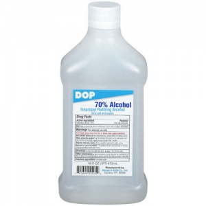

Between the mounting plate and the enclosure is white thermal grease.
This grease makes quite the mess.
There is an easy way to clean this grease that is inexpensive and safe for people.
If you try to remove it with a standard cleaner like 409, it will only smear the grease and not remove it.
Instead, you can use Isoprophyl Alcohol. Any Percent purity is fine.
This is the stuff that is less than $1 a bottle and available at any drug store or pharmacy section like at WalMart.
It will dissolve the grease and is safe for contact with human skin !
