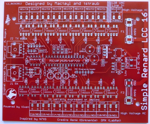

===Simple Renard 16===
===Simple Renard LCC 16===
<br/>
<br/>
[[File:SR_LCC_16.jpg|500px]]<br/>
<br/>

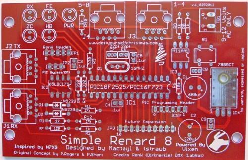

===Simple Renard 8===
<br/>
<br/>
