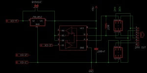

The schematic is quite simple and contains few parts. It can be made quite cheaply by replacing certain jumpers, etc with wires. The output jumper layout to support both Renard or DMX wiring schemes was taken from member RPM's E1.31-Renard/DMX bridge. Setting all of the jumpers one way uses the pseudo standard RJ45 DMX format with D+/D- on 1/2 and ground on 7. Setting all the jumpers the other way selects Renard format with D+/D- on 4/5 and ground on 1/2. Note that in both cases, it is still DMX output - this just saves you from making a special cable so that straight Cat5 patch cables can be used. The board includes an optional 78L05 voltage regulator that can be used if you exclusively use 12v pixels. This will convert the voltage to 5v for the RS485 chip but can be bypassed if you have 5v pixels.

Schematic
E68X-DMX Schematic
