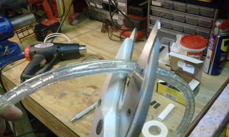

Start by cutting your rope light down to size. For this project I had purchased a 150' spool of rope light that had 18" cut spacing. I cut the rope light down to 3' sections.

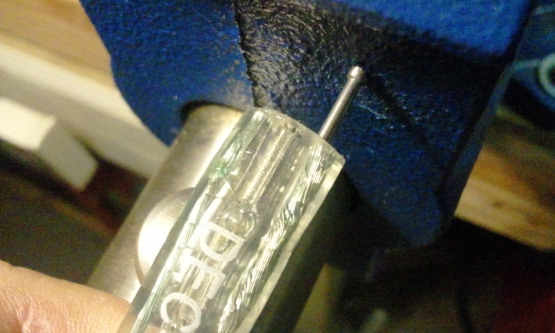

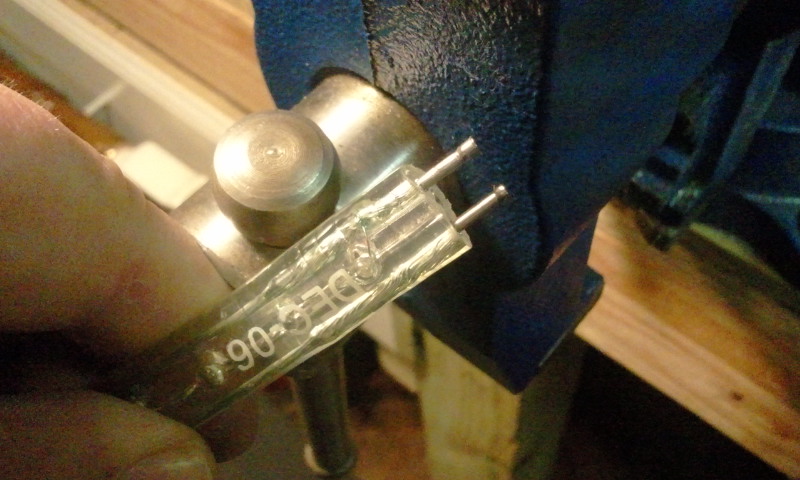

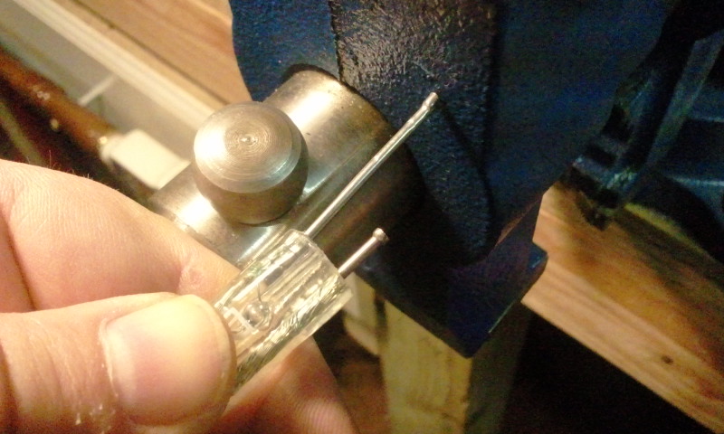

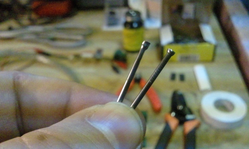

You will need two 1 1/4" 3d nails. These will be put into the rope light to create terminals.

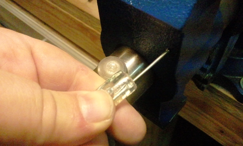

Place the first nail at one of the braided wires in the rope light.
Using hard surface, push the nail into one braided wire.
This is the nail nested in the braiding.
Repeat with the other nail on the other side of the rope light braided wire.
Both nails inserted.

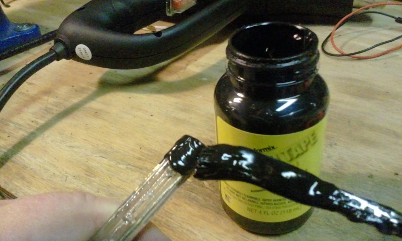

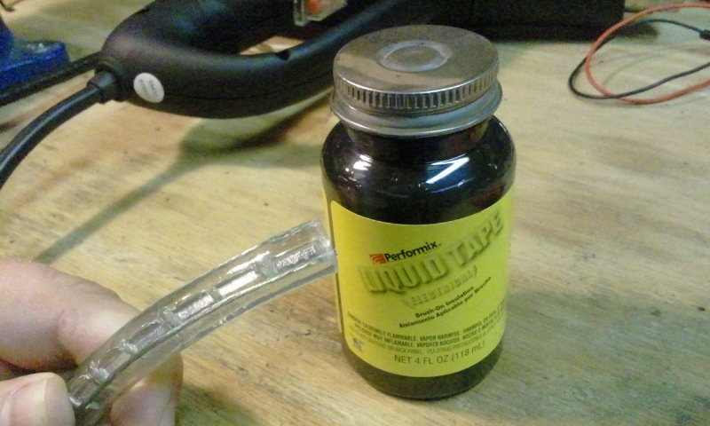

Use liquid electrical tape on the other end...
... to protect and cover the exposed braided wire of the other end of the rope light.

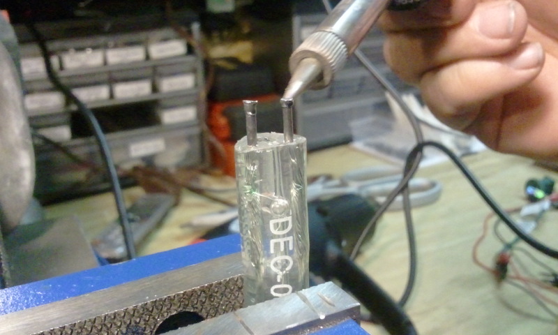

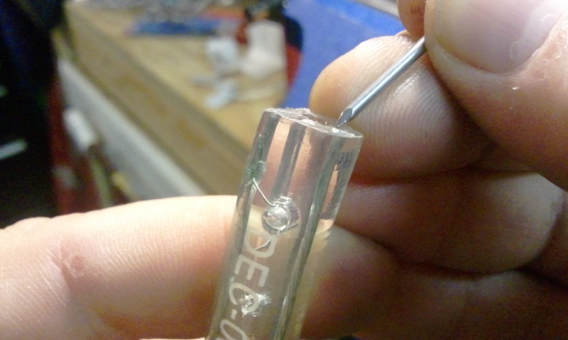

Using the soldering iron to heat the nails.
Apply solder to the heated nails to connect them to the braided wires in the rope light.
Completed soldered terminals.
