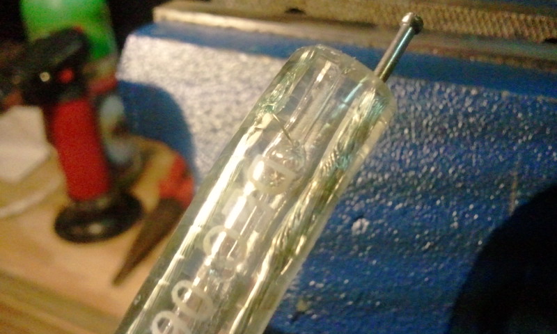

You will need two 1 1/4" 3d nails. These will be put into the rope light to create terminals.
Place the first nail at one of the braided wires in the rope light.
Using hard surface, push the nail into one braided wire.
This is the nail nested in the braiding.
Repeat with the other nail on the other side of the rope light braided wire.
Both nails inserted.
