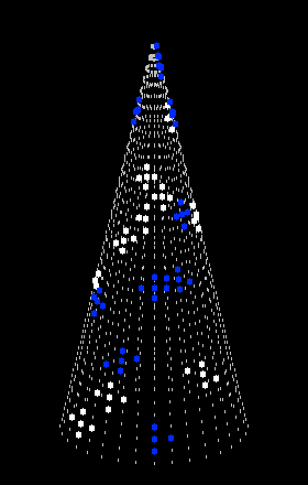

Generating Snowflake Effects
EFFECT_CLASS: snowflakes Snowflakes on your RGB device
  1. Name for your effect (Up to 25 characters):
    This is the name that this effect will show up in your library.
    The name will be upshifted and spaces will be changed to underscores. So "Sean Effect" will be come "SEAN_EFFECT".
  2. How much of your tree should be displaye (0-360 ):
    360 means display your entire tree, this would be the normal value here.
    If you choose 180 degrees, then one half of your tree will be displayed. 360 means display the entire tree.
    This could be used when there is bleeding from the back of the tree thru the front.
    The barber pole effect works best when it only displays on half of the tree.
    If you choose 180, then 90 degrees to the left and 90 degrees to the right of the front of the tree will display.
  3. Choose a color for the start of meteor trail (#000000 - #FFFFFF):
    Pick the color for the very top of the tree. This color will change into the bottom color.
  4. Choose a color for the bottom of the meteor trail (#000000 - #FFFFFF):
    Pick the color for the very top of the tree. This color will change be the final color morphed from the top color.
  5. Delay between frames (in ms) (1-1000. 50 is typical):
    This delay will be used when building the animated GIF AND when producing the xml output files.
  6. Enter the percentage of pixels to sparkle (0-100):
    If you enter a zero, no pixels will be lit up as white.
    If you enter a 20, then 20% of the pixels being drawn will have their color overridden to be white.
  7. Sequence Duration (in seconds) (0.01 to 10.0):
    Enter the total time you want this sequence to run. For now, i will limit this to 10 seconds max

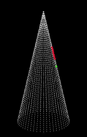

Generating Meteor Effects
EFFECT_CLASS: meteors Falling meteors on your RGB device

  7. How long of a meteor trail (1 to Maximum pixels in a Strand):
    How many pixels behind the meteor head do you want a trail
  8. Sequence Duration (in seconds) (0.01 to 10.0):
  9. How many meteors to launch each frame (1 to total pixels on your tree. Numbers ike 6-12 are reasonable.):
    Each frame, this many meteors will be randomly launched on your tree
  10. Random Color Code (1,2 for random, any other number then we use your start and end color):
    1=multicolor meteors, 2=random colrs but each meteor is same hue
Generating Garland Effects
EFFECT_CLASS: garlands Falling circles on your rgb device
  3. Choose a color for the top of the spiral (#000000 - #FFFFFF):
  4. Choose a color for the bottom of the spi (#000000 - #FFFFFF):
  8. Spacing Between Garlands (3 to maxPixels):
    When a garland drops, how many pixels gap should there be ,
    before the next gaeland drops
  9. What type of garland (0-4):
    This is the type of line drawn around your tree.
    0 .. Circle
    1 .. Garland type 1
    2 .. Garland type 2
    3 .. Graland type 3
    4 .. Garland type 4
  10. Show Frame (Y or N):
    If this is set to Y, then yout target model will be displayed as
    gray lines with no lights turned on.
