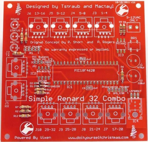

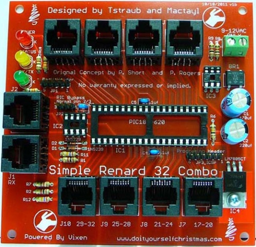

The Simple Renard 32 Combo was designed to fit in the CG-500 Demarcation Enclosure available from numerous vendors including www.wlcventures.com
Building the Simple Renard RGB+W
Assembly
THIS SECTION IS UNDER CONSTRUCTION. IT IS NOT CORRECT, PLEASE CHECK BACK IN A FEW DAYS...
The Simple Renard RGB+W is a simple device to assemble and test. It is easiest if you build the units by inserting the various components from smallest to tallest .

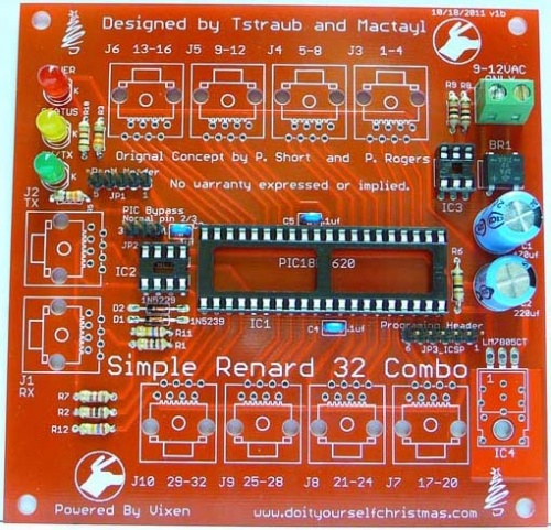

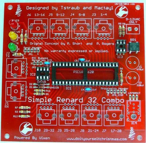

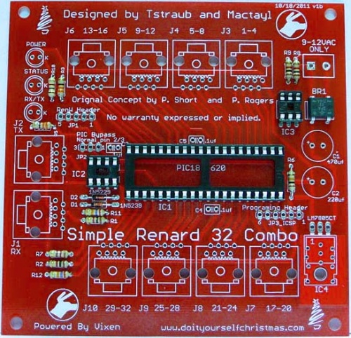

- Begin by inspecting the PCBs to look for any defects such as cracks or breaks. The holes on the board should be open on both sides. Then inspect and sort out the various parts for the board.
- Install the resistors:
- Install the 1K ohm resistors at locations R1,R2,R6. The resistor are not polarized, so they can go either way.
- Install the 330 ohm resistors at locations R3,R7. The resistor are not polarized, so they can go either way.
- Install the 10K ohm resistor at location R4. The resistor is not polarized, so it can go either way.
- Install the 120 ohm resistor at location R5. The resistor is not polarized, so it can go either way.
- Install the 27K ohm resistors at locations R9,R10. The resistor are not polarized, so they can go either way.
- Install the 820 ohm resistors at locations R11-42. The resistor are not polarized, so they can go either way.
- Install the capacitors:
- Install the 47uf Electrolytic Capacitors at locations C1,C2. The capacitors are polarized. The side of the capacitor will have a stripe on the negative side. The long lead is the positive side, and it goes in the hole marked with a +.
- Install the 0.33uf Ceramic Capacitor at location C6. The capacitor is not polarized, so it can go either way.
- Install the 0.1uf Ceramic Capacitors at locations C3,C4,C5. The capacitors are not polarized, so they can go either way.
- Install the IC sockets:
- Install the 8 pin socket at location IC1. The notch on the socket should face the right side of the board, matching the silkscreen image.
- Install the 40 pin socket at location IC2. The notch on the socket should face the right side of the board, matching the silkscreen image.
- Install the diodes:
- Install the 1N5239 diode at location D1. The diode is polarized and it can only go one way. The end with the band (cathode) goes towards the left side of the board.
- Install the 1N5229 diode at location D2. The diode is polarized and it can only go one way. The end with the band (cathode) goes towards the left side of the board.
- Install the transistors:
- Install the PN2222AG NPN transistors at locations T1-32. The transistors are polarized and can only go one way. The transistors should be installed with the flat side matching the silk screen image. T1-16 on the top side of the board should have the flat side facing to the right side of the board. T17-32 on the bottom side of the board should have the flat side facing to the left side of the board.
- Install the light emitting diodes:
- Install the Red LED at the location marked Power. The LED is polarized. There is a flat side (cathode) that has a short lead and it faces towards the right side of the board.
- Install the Yellow LED at the location marked Status. The LED is polarized. There is a flat side (cathode) that has a short lead and it faces towards the right side of the board.
- Install the Green LED at the location marked RX/TX. The LED is polarized. There is a flat side (cathode) that has a short lead and it faces towards the right side of the board.
- Install the headers:
- Install the 5 pin header at location JP2 (RENW header). The short side of the header strip goes into the board.
- Install the 2 pin header at location JP3 (VREG bypass). The short side of the header strip goes into the board.
- Install the 3 pin header at location JP4 (PIC bypass). The short side of the header strip goes into the board.
- Install the 6 pin header at location ICSP (PIC programing header). The short side of the header strip goes into the board.

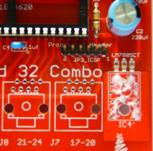

- Install the 5v linear regulator at location IC3. The voltage regulator is polarized and goes only one way. Gently bend the leads of the regulator at the location on the leads where it changes size down at a 90 degree angle towards the flat side of the regulator. Apply thermal grease to the flat heat sink side of the regulator and fasten it to the pcb using a #4 screw and nut.
- Install the RJ45 jacks at locations J1-10. Gently align the eight wires with the matching holes and snap the connector to the board. Solder the connector to the circuit board being careful to not short out the connectors.
- Install the 2 terminal strips at locations TB1,TB2. The side where the wires enter under the screw should face the right of the board.
- Install the jumper shunts:
- Install the shunts on the headers according to the Header Settings listed below.

Outputs
The outputs of the Simple Renard 32 Combo is connected via straight thru Cat5 cables to SSRs.
J3 is Output channels 1-4
J4 is Output channels 5-8
J5 is Output channels 9-12
J6 is Output channels 13-16
J7 is Output channels 17-20
J8 is Output channels 21-24
J9 is Output channels 25-28
J10 is Output channels 29-32
RJ45 output jacks are wired as follows:
Pin 1 - +5vdc Pin 2 - First Channel Output Pin 3 - not connected Pin 4 - Second Channel Output Pin 5 - not connected Pin 6 - Third Channel Output Pin 7 - Ground Pin 8 - Fourth Channel Output
Power Connections
Warning...The Simple Renard 32 Combo does not have an on-board fuse. You must use an external/inline fuse holder with a 1A fuse for the power input for safety.
The board is powered by connecting a 9-12vac power supply to the power input terminal connector on the upper right corner of the board. The power supply must be AC to generate the zero crossing signal for dimming ac circuits.
The on board voltage regulator circuit generates the +5vdc to power the on board circuits and provide switching signals to the attached SSRs.
