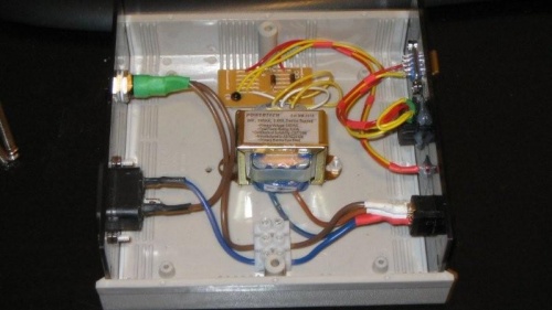

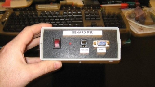

Wjohn's  home made power supply, based on the circuit above.
Inside wjohn's home made power supply, based on the circuit above. The case is an ABS instrument case, and the transformer is mounted using plastic hardware (insulated). The RJ45 is a PCB mount version, that has been 'hot glued' to the front panel. The wiring is kept tidy by using heat shrink tubing around the cable runs. AC is connected to the PSU via the IEC socket on the rear panel. A panel mounted fuse holder is used to keep things safe and an illuminated power switch and DC powered LED provide inidication of status of the PSU on the front panel.
Below is a PCB based version of the power supply. This was the first version constructed by Wayne. There is a second version undergoing evaluation. Version 2 will include onboard RS-232 to RS-485 conversion, as well as the power supply in Version 1.
