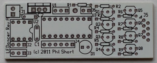

PCB Schematic
This is a generic LEDancer schematic, useful as the basis of a PCB design. Some of the necessary details (such as a DC regulator) have been omitted from the schematic, but should be included in most PCB designs.
PCB Design
The design consists of a controller board with a PIC16F1826 and a ST485 RS485 receiver, a jumper for enabling the DMX Address Program Mode, eight resistors and 8 2N3904 transistors, and some connectors.
Connector Pinout
J1-Power
J1 is the 2 pin header located at the top left side of the PCB. The LEDancer can be powered by 5-24VDC. If you are using 5VDC, omit the voltage regulator and jumper the voltage regulator position by soldering a wire jumper to where the two outer pins of the regular would have gone in position U1 near the top left side of the PCB. If you are feeding greater than 5VDC, then you must use the on board voltage regulator.
Round Hole closest to the top of the board: Negative Power feed
Square Hole: Positive Power feed
J2 and J3-DMX Input and Output
The two 3 pin jumpers J2&J3 near the bottom left side of the board are used to bring DMX signals to and from the board. The 3 pin connectors are polarized and should be connected as follows:
Pin 1 is the Square hole of the three holes on the side towards the center of the board: Connect to DMX Ground
Pin 2 is the center hole of the three holes: Connect it to DMX Data -
Pin 3 is the left most hole of the three holes: Connect it to DMX Data +
Note that the two 3pin DMX connections are setup as a thru connection and can be used as either the input or output of the board. If the LEDancer is the last connection on a DMX data line, it may be necessary to add a 120 ohm terminating resistor to the unused DMX terminals between PIN 2 and Pin 3.
J4-ICSP Programing Header
J4 is the 6 pin header located in the bottom center of the board. J4 allows the PIC microprocessor to be programmed in place on the board by directly connecting a PICKIT2 or PICKIT3 programer.
Pin 1 is the square hole towards the right side of the board closest to D1.
J5 (2 pin)- DMX Address Programming Jumper
J5 is located in the top center of the PCB. By default the LEDancer is initially programmed to DMX address 1 by the firmware. The address may be changed in the device by either modifying the firmware or by using the special programming instructions listed below. You must temporarily install a shorting jumper across the two pins of J5 to use the special address setting packets.
J5(8 pin)- Output to LEDs
J5 is located along the right edge of the board and is a 8 pin connector used to connect to the LED Segment PCB. Pin1 of the connector is marked by the arrow next to it on the silkscreen.
Jumper Identification
J1-Power
J2-DMX
J3-DMX
J4-ICSP Programming Header
J5 (2 pin)- DMX Address Programing
J5(8 Pin)- Output to LEDs
Unumbered 3 Pin- ???

LEDancer Controller Assembly
  1. Install resistors
    1. Solder one 330 ohm resistor in R1 on top center of the PCB. The resistor is not polarized and can go either way. The 330 ohm resistor is optional and is only needed if you are installing the green LED on the controller board.
    2. Solder eight 82 ohm resistors in R2-R9 on the right side of the PCB. The resistors are not polarized and can go either way.
  2. Install IC sockets
    1. Solder one 8 pin IC socket on the left side of the PCB at U2. Install the socket with the notch facing to the right side of the PCB, matching the silkscreen.
    2. Solder one 18 pin IC socket on the left side of the PCB at U3. Install the socket with the notch facing to the right side of the PCB, matching the silkscreen.
  3. Install capacitors
    1. Solder one 0.1uf capacitor in C1 on the center left side of the PCB. The capacitor is not polarized and can go either way.
    2. Solder one 0.33uf capacitor in C2 on the top left side of the PCB. The capacitor is not polarized and can go either way.The 0.33uf capacitor is optional and is only needed if the voltage regulator is installed.
  4. Solder the eight 2N3904 transistors in Q1-Q8 on the right hand side of the PCB. The transistors are mounted with the flat side facing the top of the board matching the layout on the silkscreen.
  5. Solder the green LED in D1 in the bottom center of the PCB. The LED is polarized and the long lead goes to the right side of the PCB.The green LED is optional and is currently not used by the firmware.
  6. Install the headers. The short end of the header is soldered into the PCB.
    1. Solder two 2 pin headers in J1 on the top left of the PCB and J5 in the top center of the PCB.
    2. Solder three 3pin headers in J2 and J3 on the bottom left of the PCB and in the unmarked 3 position location in the top center of the PCB underneath where the silkscreen says U1 and R1.
    3. Solder one 6 pin header J4 in the bottom center of the PCB.
  7. Solder the voltage regulator in U1 on the top left side of the PCB. The voltage regulator is polarized and the heatsink side faces the top of the board.The voltage regulator is optional and is only needed if the power to the LEDancer is greater then 5V. If the LEDancer is powered by a regulated 5VDC power supply, you must omit the voltage regulator and install a wire jumper between the two outer pins of where the voltage regulator would go.
  8. Install ICs
    1. Install the 18 pin PIC in U3 in the center of the board. The notch on the IC faces towards the right side of the board matching the silkscreen.
    2. Install the 8 pin RS485 chip in U2 on the left side of the PCB. The notch on the IC faces towards the right side of the board matching the silkscreen.
