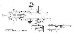

Schematic and PCB layout
The schematic and PCB layout are documented in a .pdf file.
This document shows the electronic board schematic and the PCB layout for the main transmitter board.
What is not shown is the information for the 'Display' board of this two board set.
[Click Here for the full Schematic & PCB layout File]
