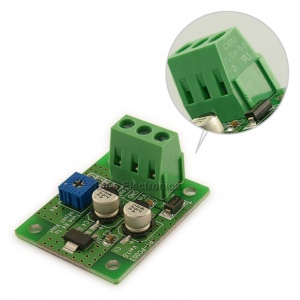

DO NOT apply anything GREATER then REGULATED 9V-16V DC to your unit. If you aren't sure, then ask for help in the forums. Use a meter to check the voltage first. If all you have is a wall-wart that is labeled 12V, then that is most likely NOT regulated. A simple test of the output voltage with a meter will tell the tale. I use one of the voltage regulators from Sure Electronics with my unit (Part number:PS-SP12113). These are about $5 online.
You need very little power for an FM02. A power supply rated at only 100ma is sufficient.
