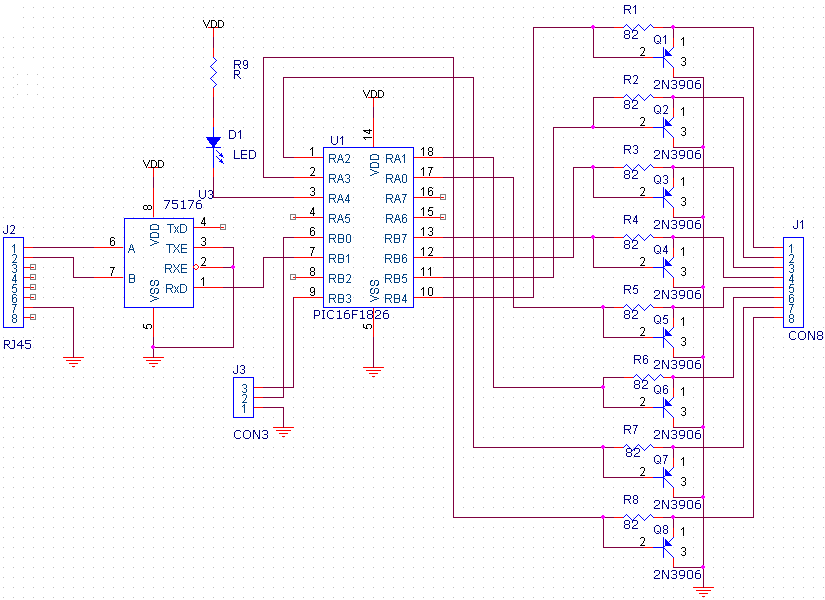

PCB Schematic
This is a generic LEDancer schematic, useful as the basis of a PCB design. Some of the necessary details (such as a DC regulator) have been omitted from the schematic, but should be included in most PCB designs. There are a lot of lines crossing each other in this schematic, but that is only because I put pin 1 of the connector at the top of the schematic page, rather than the bottom.

At the moment there isn't a released PCB design. The design consists of a controller board (with a PIC16F1826 and a ST485 RS485 receiver, a jumper for enabling the DMX Address Program Mode, eight resistors and 8 2N3906 transistors, and some connectors.
Here is a proposed sample PCB design:
