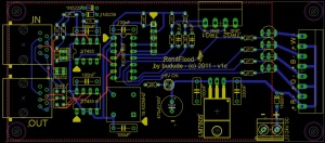

Ren4Flood Construction Manual
== THIS IS A WORK IN PROGRESS - NOT FINAL!!! ==
What is the Ren4Flood?
The Ren4Flood is a four channel controller primarily aimed at controlling an RGB+W LED flood such as the MightyMini, Rainbow Flood (RGB only) or the DIYC Flood. It uses the existing Renard architecture and code which has been modified to only consume four channels versus the normal eight that a Renard uses per PIC. The logic/control/communication portion of the circuit comes straight from the RenardSS series of controllers so much of the credit goes to Wayne James and of course Phil Short for their contributions. The output section is taken from the Ren48LSD but reduced to only four channels. One minor difference on the RS-485 interface is that jumpers have been added to bypass the input directly to the output creating a non-regenerated "THRU" port instead of the more common output port on the RenSS series. This allows you to use static node addressing without affecting other nodes further up/down the line.
The other significant difference with the Ren4Flood is that it employs two input trigger ports. While this is not completely defined at the moment, the idea is of at least two different scenarios. The first allowing the installation of a switch to be mounted to the flood enclosure and simply turning on all of the LEDs to create a bright flood to be used during setup or off-season. The other scenario is using a trigger for security reasons. The input would be connected to some type of N/O switches and closing the switch would trigger the board to perform some type of light effect to scare off and/or alert you to this. Additional code could be used to monitor the input for data and if after a particular time period passes with no traffic (say 15 minutes), a light pattern would start for a set length of time to create simple mood/background lighting after the show completes.
How does the Ren4Flood work?
As mentioned before, the Ren4Flood uses the same architecture for the logic portions of the board from the RenardSS series of boards. Sequence information is passed from a PC running Vixen or other sequencing program via an RS-232 or RS-485/DMX interface. The ST485 chips receive this information and turn into standard TTL logic levels that the PIC can understand. The PIC reads in the data and if it determines that the information corresponds to itself, it updates the dimming levels of all 4 channels. It removes this information from the stream and feeds the rest out to the other ST485 chip which translates it to RS-485 levels for the next controller in the line. It is important to realize that the information is removed from the stream and that the resultant leftover stream will have all of the data offset by the 4 channels of information used by the Ren4Flood. For example, if you have two Ren4Flood, on Vixen you would configure a single Renard/DMX plug-in with 8 channels. The first Ren4Flood consumes the first 4 channels of information leaving only 4 channels on it's outputs. The second Ren4Flood will see this incoming data as controller #1 again and assume the data is for it. This is very much different than standard hard/soft-coded DMX or LOR devices that use a set address yet still pass on the entire stream to the next controller on the line. There are advantages and disadvantages to either approach - but you should be aware of this when combining normal DMX devices before/after a Ren4Flood (or any Renard controller running DMX code).
The Ren4Flood has a jumper to bypass this however and can pass the data straight from the input to the output plug. This means you will need to set the hardware address by programming the PIC with different addresses on each Ren4Flood controller.
The PICs receive the data on pin 5 and after consuming their 4 channels of data, forward the rest out of pin 6 of the PIC which in turn goes to the next controller if you have one attached as mentioned above.
The board requires a 12-24vdc supply which is converted to +5v for the logic portion of the controller but is also fed directly out to the outputs via the transistors.
The Ren4Flood uses sourced outputs and not sinked outputs like the RenardSS controllers. Why is this? Because the PIC needs to turn on a transistor and to do this, it supplies 5v on it's output which turns on the transistor (via a resistor to limit the current) which allows current to flow from the collector to the emitter of the transistor. The emitter is directly connected to ground so basically, the transistor sinks the current from the LEDs (or whatever you have attached to the output) to ground. The positive voltage from the DC power supply connects directly to the device you have attached and this completes the circuit.
Revision History
The v1c version is currently the only version of the Ren4Flood in production.

Building the Ren4Flood
NOTE - THE ASSEMBLY STEPS ARE NOT FINAL FOR THE REN4FLOOD YET - COMING SOON!
The Ren4Flood requires a modest bit of soldering so take your time and ensure you install the components in the correct orientation when required. Start by sorting the components by type and values. Look over the PCB before starting noting the location of the various components. Follow the standard procedure of installing the lowest profile parts first and ending up with the tallest.
1. Install the three 10k resistors near top center of the board
2. Install the four 1k resistors two near the top 485 chip and two near the middle of the board
3. Install the two 27k resistors near the top 485 chip
4. Install the one 120 resistor near the top 485 chip
5. Install the one 680 resistor near the LED in the middle of the board
6. Install the 1N5229 diode above the top 485 chip – note the correct orientation - the band on the diode goes towards the right side of the board
7. Install the 1N5239 diode above the top 485 chip – note the correct orientation - the band on the diode goes towards the left side of the board
8. Install the four 470 ohm resistors near the right side of the board
9. Install the five 0.1uf decoupling capacitors near the IC sockets, oscillator and near the voltage regulator. Note that the silkscreen says 100nF.
10. Install the one 0.33uf capacitor to the right of the voltage regulator. Note that the silkscreen says 330nF. The BOM lists a 0.22uf capacitor, either a 0.22uf or a 0.33uf can be used.
11. Install the two 1.0uf capacitors and near the ICSP header. Note that the silkscreen says "1uF".
12. Install the one 14-pin PIC chip socket and the two 8-pin 485 chip sockets - note the correct orientation with the socket notch in the same direction as the silk screen.
13. Install the 18.432MHz oscillator – note the correct orientation - the package has one square corner (and a dot) and that goes into the square hole on the board
14. Install the two 2-pin headers on the left side of the board in the term and rs232 holes
15. Install the one 2x3-pin header to the left of the bottom rs485 chip
16. Install the one 5-pin header in the top center of the board int the holes marked ICSP
17. Install the LED – note correct orientation - the flat side of the LED faces to the left. The longer leg of the LED goes in the hole to the right.
18. Install the one 2-terminal DC input terminal blocks – note correct orientation - have the side where the power wires will be inserted facing the bottom of the board
19. Install the one 4-terminal trigger terminal block on the top right of the board.
20. Install the one 8-terminal flood terminal block to the right side of the board.
21. Install the LM7805 regulator - note correct orientation - pin 1 is denoted by the dot on the package and the board. Mount the heat sink to the device and use a small amount of heat sink compound
22. Install the one 1N5819 diode near the voltage regulator ( – note the correct orientation - the diode has the band on the diode facing towards the top of the board. NOTE - If you are using the Ren4Flood with the DIYC Flood do not install this diode - instead use a jumper
23. Install the 470uF/16v capacitor – note correct orientation - the capacitor has a stripe on the side denoting the negative leg that goes in the hole near the "-"mark on the board.
24. Install the two RJ45 jacks – note that side-entry jacks can be substituted
25. Install the 4 transistors – note the correct orientation – the flat side of the package faces towards the bottom of the board.
Congratulations! That completes the construction of the Ren4Flood!

PCB
The PCBs for the Ren4Flood were designed by Brian Ullmark (budude). The PCB is available by contacting dlovely
