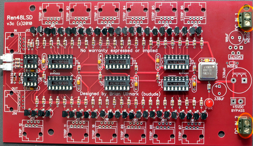

Ren48LSD (v3c) Construction Manual
What is the Ren48LSD?
The Ren48LSD (LED Strip Driver) controller came about as a solution to drive Frank's LED Super Strips. Originally I used DCSSRs to drive them and while it's a workable solution, it tends to be somewhat bulky and requires lots of additional wiring between the controller and DCSSRs as well as to the strips themselves. Another alternative is Frank's Ren24LV which uses ULN2803 drivers. The issue with this solution is that it has limitations in how much power it can sink to the strips due to the ULN2803 package power dissipation.
The strips require up to 360mA per output (18 LEDs x 20mA) so I used an NPN bipolar transistor to drive them. The transistors support up to 600mA so there's plenty of headroom left. The transistors are fairly cheap so it makes for a simple, inexpensive solution. The controller design used the Ren24SS as a base, using the same PIC, clocking and serial interface configuration but expanded to 6 PICs to support 48 channels or driving up to 12 strips per board. Because of this, the controller supports standard Renard protocol FW using RS-232/485 as well as the DMX version. The board requires either a 5vdc well regulated supply or a good 9-24vdc supply. The input supply also drives the LED strips.
For information on the previous version of this board (v3b) please go to Ren48LSD. This page is for the v3c version of the board.
How does the Ren48LSD work?
The Ren48LSD uses the same architecture for the logic portions of the board from the RenardSS series of boards. Sequence information is passed from a PC running Vixen or other sequencing program via an RS-232 or RS-485/DMX interface. The ST485 chips receive this information and turn into standard TTL logic levels that the PIC can understand. The PIC reads in the data and if it determines that the information corresponds to itself, it updates the dimming levels of all 8 channels. It removes this information from the stream and feeds the rest out to the next PIC and that one performs the same. This is repeated for all 6 PICs. The last PIC, PIC 6, feeds what's left of the stream out to the other ST485 chip which translates it to RS-485 levels for the next controller in the line. It is important to realize that the information is removed from the stream and that the resultant leftover stream will have all of the data offset by the 48 channels of information used by the Ren48LSD. For example, if you have two Ren48LSDs, on Vixen you would configure a single Renard/DMX plug-in with 96 channels. The first Ren48LSD consumes the first 48 channels of information leaving only 48 channels on it's outputs. The second Ren48LSD will see this incoming data as controller #1 again and assume the data is for it. This is very much different than standard hard/soft-coded DMX or LOR devices that use a set address yet still pass on the entire stream to the next controller on the line. There are advantages and disadvantages to either approach - but you should be aware of this when combining normal DMX devices before/after a Ren48LSD (or any Renard controller running DMX code).
The PICs receive the data on pin 5 and after consuming their 8 channels of data, forward the rest out of pin 6 of the PIC which in turn goes to pin 5 of the next PIC. PIC #6 or the last PIC feeds the next controller if you have one attached as mentioned above. All of the PICs are fed the same clock from the external oscillator.
The logic portions of the board require a steady +5vdc supply. This can be supplied in two ways on the Ren48LSD. If you use a well-regulated +5vdc power supply, you skip installing all of the regulator circuitry and install a jumper across the +5vdc bypass connector. This will feed the power from the DC IN 1 jack directly to the logic components. Obviously care must be taken to ONLY use a 5vdc supply - if a 12v supply is connected in this configuration, you will probably lose all of your PICs, ST485 chips and the Oscillator in one shot. If you are planning to use a 9-24vdc supply then you must install the regulator circuitry. This allows the power supplied on the DC IN 1 connector to be converted down to +5vdc for the logic components. It is important to realize that the 5v created is only used by the logic components, it is NOT sent out to the outputs of the Ren48LSD. The outputs always follow whatever you place on DC IN 1 and DC IN 2. The two connectors are separated so it is possible to run different voltages on DC IN 1 and DC IN 2 (say 5v and 12v). Here again, extreme caution must be taken to ensure you do not mix up supplies or plug your device into the wrong outputs (say a 5v strip into a 12v output). In addition, you must ensure that the two power supplies will work harmoniously with a shared ground connection since the ground plane is shared between DC IN 1 and DC IN 2.
So - now that the PICs have the updated dimming levels for all of it's channels, it enables each of its outputs using PWM or Pulse Width Modulation. It is important to grasp that the voltage levels are not controlled - it is the amount of time on and off that is varied within a small cycle of time for each update. It seems logical that to dim things you would just change the voltage from 12v to 9v for example. Instead, the voltage is on at the full 12v for x amount of time and then it is off (0v) for the y amount of time - it is not something in-between. The cycle time is controlled by the PIC in the case of the Ren48LSD. In RenardSS boards, they use a Zero-Cross (ZC) signal which is created by an opto-isolator attached to the AC line (either directly to the mains or via a transformer and in both cases through some resistors to limit the current to the opto). Since the Ren48LSD does not have any AC supplied to it, the PIC basically makes up it's own timing but it closely resembles what is seen with normal ZC usage.
The Ren48LSD uses sourced outputs and not sinked outputs like the RenardSS controllers. Why is this? Because the PIC needs to turn on a transistor and to do this, it supplies 5v on it's output which turns on the transistor (via a resistor to limit the current) which allows current to flow from the collector to the emitter of the transistor. The emitter is directly connected to ground so basically, the transistor sinks the current from the LEDs (or whatever you have attached to the output) to ground. The positive voltage from the DC power supply connects directly to the device you have attached and this completes the circuit.

Building the Ren48LSD
The Ren48LSD requires a fair bit of soldering so take your time and ensure you install the components in the correct orientation when required. Start by sorting the components by type and values. Look over the PCB before starting noting the location of the various components. Follow the standard procedure of installing the lowest profile parts first and ending up with the tallest.

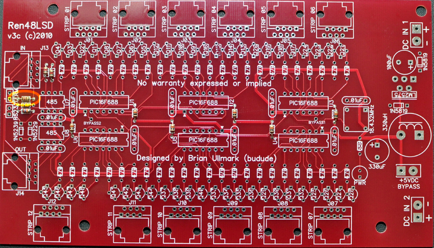

1. Install the six 10k resistors near each PIC

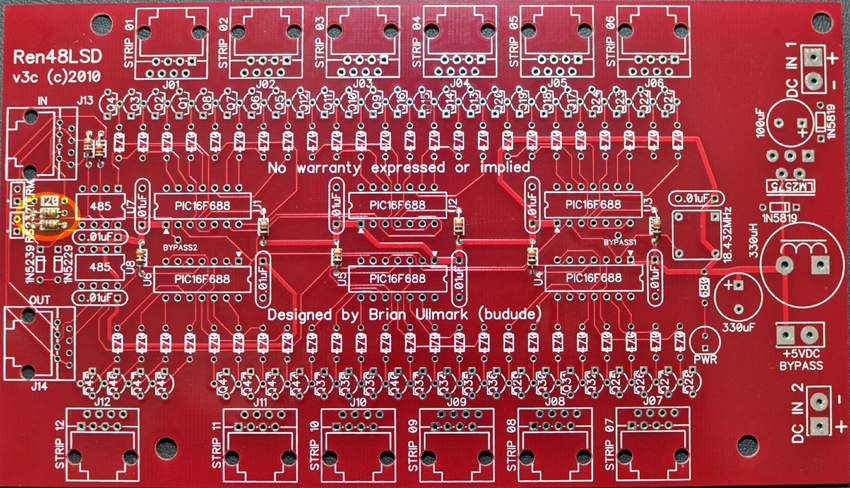

2. Install the two 1k resistors near the 485 chips
3. Install the two 27k resistors near the 485 chips
4. Install the one 120 resistor near the 485 chips
5. Install the one 680 resistor near the LED

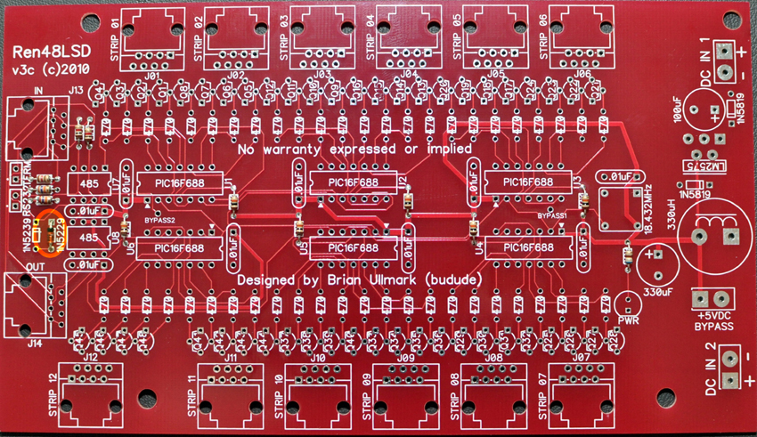

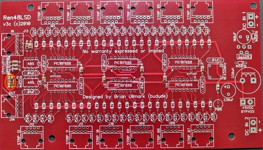

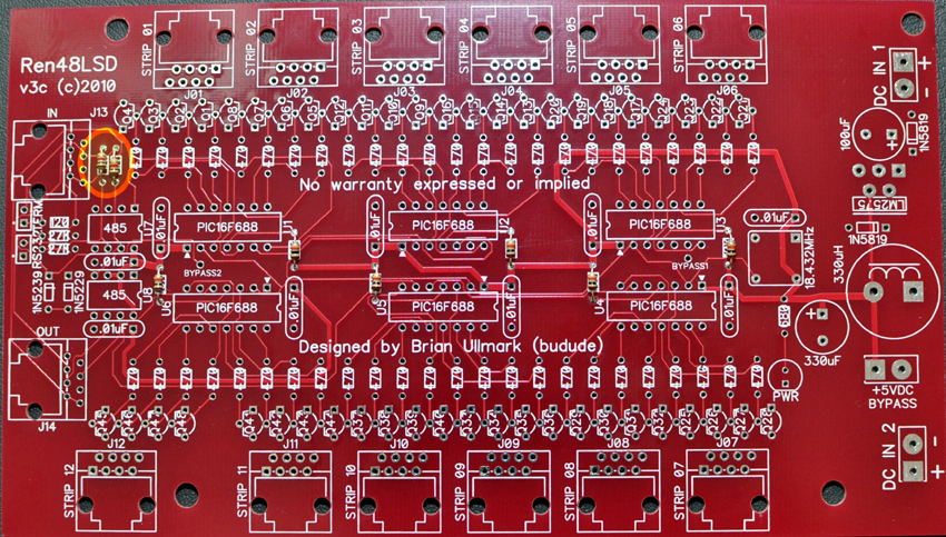

6. Install the 1N5229 diode near the 485 chips – note the correct orientation - the band on the diode goes towards the top of the board in the square hole.
7. Install the 1N5239 diode near the 485 chips – note the correct orientation - the band on the diode goes towards the top of the board in the square hole.

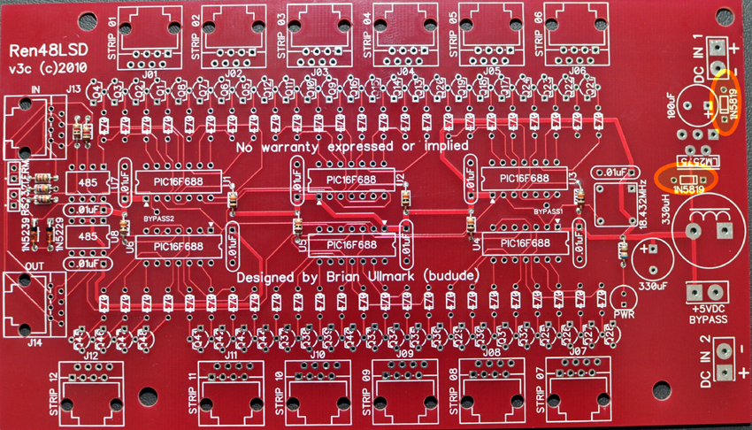

8. Install the two 1N5819 diodes near the voltage regulator (Do not install for 5vdc input) – note the correct orientation - the diode closest to DCIN1 has the band on the diode facing down and in the square hole, the diode closest to the choke has the band on the diode facing right and in the square hole.

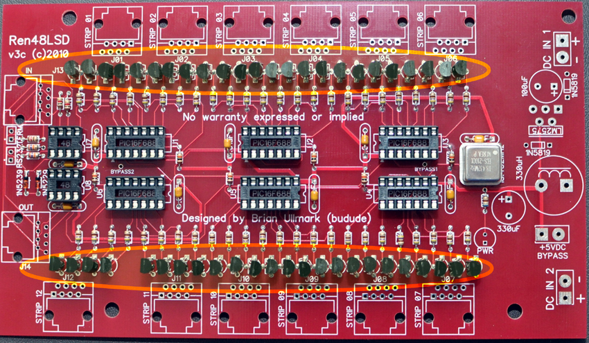

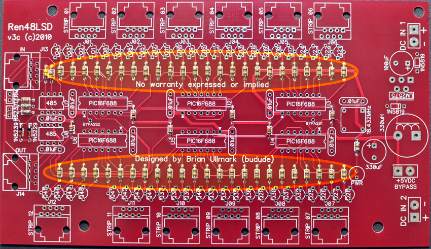

9. Install all forty-eight 470 ohm resistors doing 4-8 at a time.

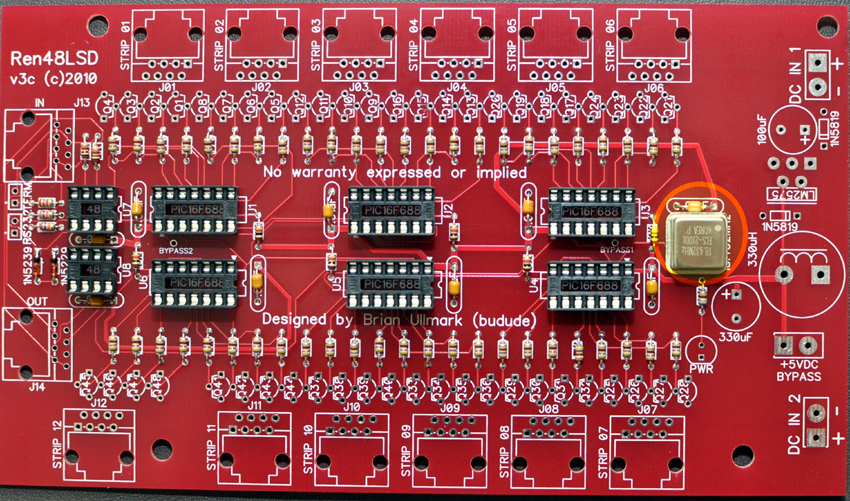

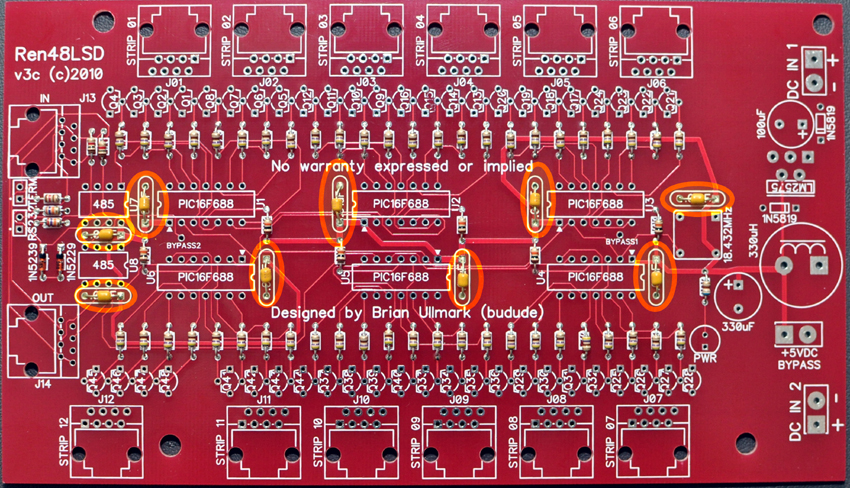

10. Install the nine decoupling capacitors near the IC sockets and oscillator. Note that the silkscreen says ".01uF" - in fact they are 0.1uF (100nF).

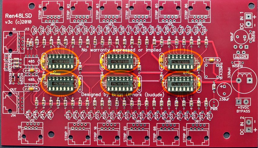

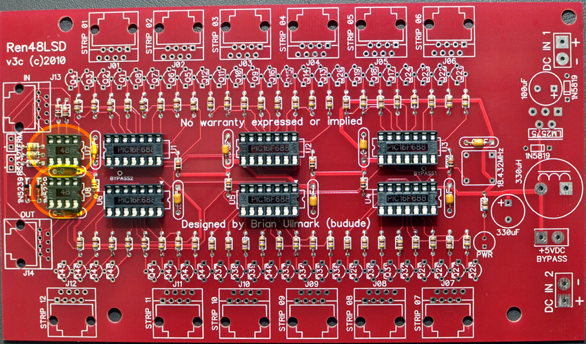

11. Install the six 14-pin PIC chip sockets - note the correct orientation - the top 3 sockets have the notch facing towards the left, and the bottom 3 sockets have the notch facing the right.
12. Install the two 8-pin 485 chip sockets - note the correct orientation - the notch faces to the right side of the board towards the PICs.

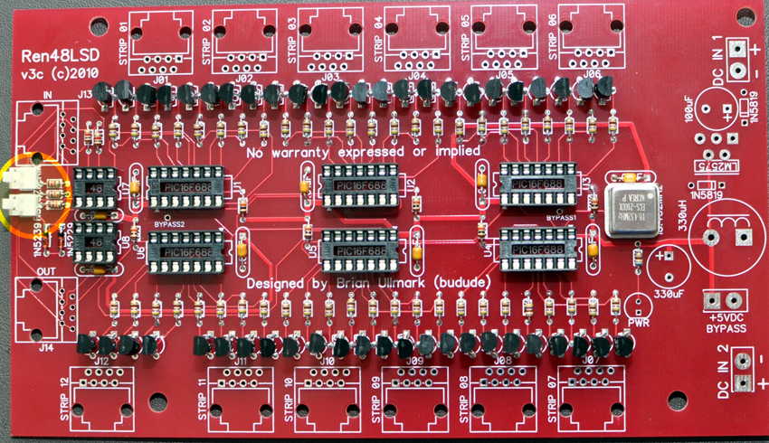

13. Install the 18.432MHz oscillator – note the correct orientation - the package has one square corner (and a dot) and that goes into the square hole on the board

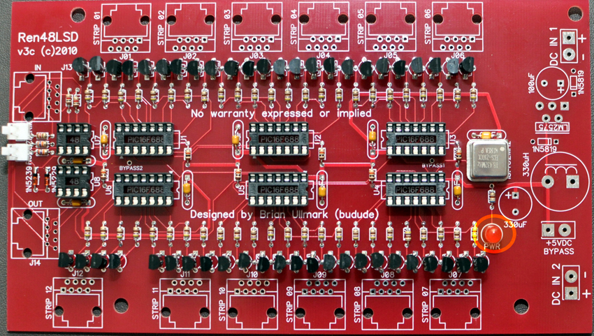

14. Install the 48 transistors – note the correct orientation – the emitter is nearest the PICs, base in the middle and collector near the RJ45 jacks. The legs of the transistors will need to be bent slightly to fit the holes. The middle leg will end up being out in front of the flat side of the transistor.

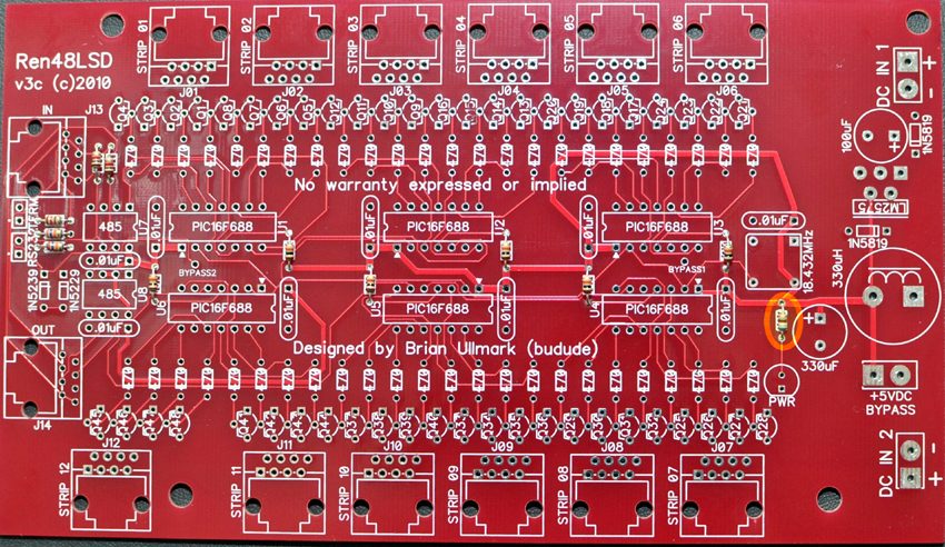

15. Install the two 2-pin shunt jumpers
16. Install the LED – note correct orientation - the flat side of the LED faces the bottom of the board and the shorter leg goes into the square hole.

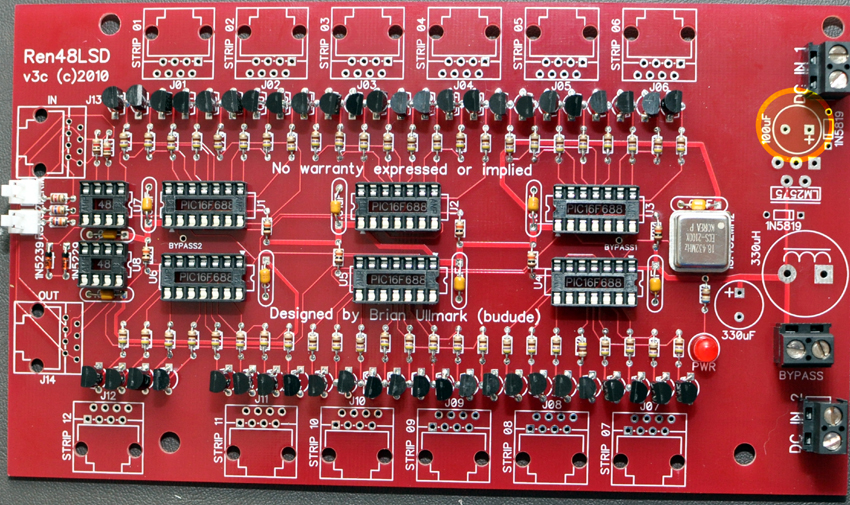

17. Install the DC input terminal blocks – note correct orientation - have the side where the power wires will be inserted facing to the right.

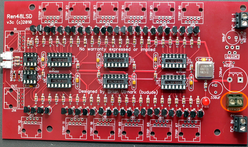

18. Install the +5vdc bypass block (Install for 5vdc input)
Note that if you are using a regulated 5vdc power supply for your input, you should omit installing most of the regulator circuitry.

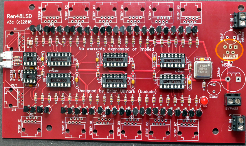

19. Install the LM2575 regulator (Do not install for 5vdc input) - note correct orientation - pin 1 is denoted by the square pad - the odd number pins are the pins farthest away from the back
20. Install the 100uF/50v capacitor (Do not install for 5vdc input) – note correct orientation - the capacitor has a stripe on the side denoting the negative leg that goes in the round hole.

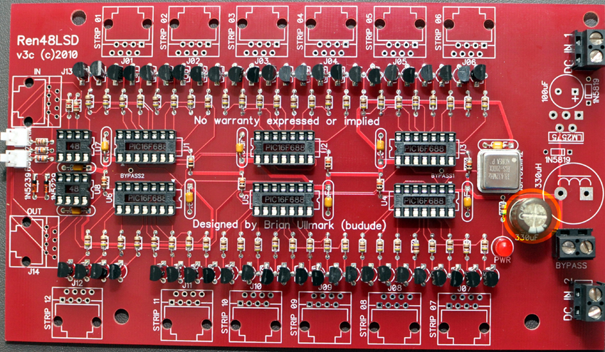

21. Install the 330uF/16v capacitor – note correct orientation - the capacitor has a stripe on the side denoting the negative leg that goes in the round hole.

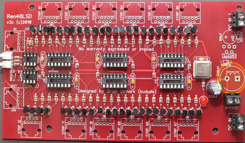

23. Install the choke coil (Do not install for 5vdc input)

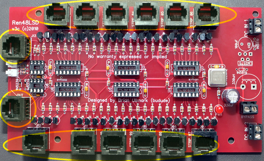

24. Install the fourteen RJ45 jacks – note that side-entry jacks can be substituted
Congratulations! That completes the construction of the Ren48LSD!

Programming the PIC controllers
The Ren48LSD does not supply or use a ZeroCross input and therefore the Renard firmware (either Renard or DMX protocol) must be configured for DC/PWM operation. In addition, if you are using the DMX firmware, you may want to set the initial starting address but generally, this can be left at '1' for all PICs since the code is self-addressing. Also – like the ULN2803 drivers, the transistors invert the output so the firmware uses positive outputs.
Renard Protocol
Obtain the standard Renard firmware here:
Make the following changes:
#define PWM_build 1 – change from '0'
#define DC_build 1 – change from '0'
#define CTR_LOCKOUT 1 – change from '15'
;#define OUTPUT_NEGATIVE_TRUE – comment this out
Compile the code into hex code and program all six PICs with the same code. A standard version of the code with the settings above has been compiled already for you in the File Library available here.
Renard-DMX Protocol
Obtain the DMX Renard firmware from here:
#define CTR_LOCKOUT 0 – change from '40'
#define SINK_map 0x00 – change from '0xFF'
If you want to change the DMX starting address then alter it below – this is only required on the first PIC in the chain. If you have multiple Ren48LSD controllers, you can leave the second/subsequent PICs at '1' and they will automatically start off where the last PIC left off.
#define DMX_START_ADDRESS 1
Compile the code into hex code and program all six PICs with the same code (unless using a starting address). A standard version of the code with the settings above has been compiled already for you in the File Library available here.
Whichever firmware you choose, install the flashed PICs into the sockets noting the correct orientation. Also install the two 485 chips into their sockets noting the correct orientation. You are now ready for final testing.

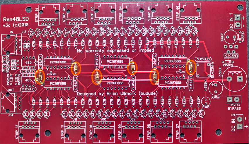

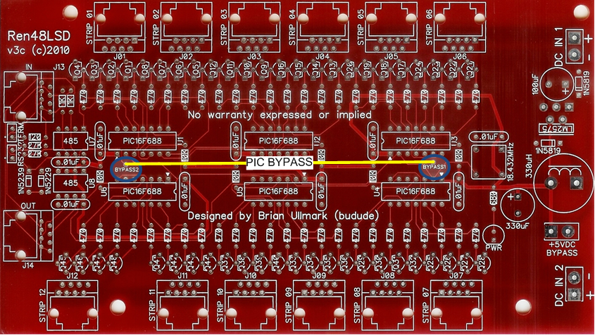

Q1: What if I only have 6 strips?
A1: Well - you're in luck! Next to PIC #3 and PIC #6 is a via hole that will bypass PICs #4 - #6 if you install a wire between them. Note that this is only necessary if you are planning to daisy-chain another board from this one. This effectively makes this a Ren24LSD. If you are not going to daisy-chain another board, you can leave it off as well as the RS-485 output chip. Personally, I think this is false economy since you'll have to dig the parts up if you change your mind and want to run a board off this one. In either case, you certainly save time and money by not installing the PICs, sockets, transistors, resistors and output connectors for strips 7-12 if you don't have them.
