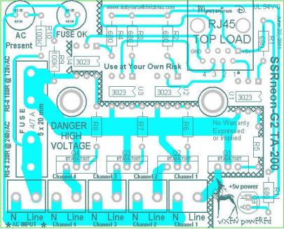

The SSRneon is a 4 port AC Solid State Relay (SSR). It is derived from the same basic design that has been in general use by the DIY community for many years. Most of the DIY SSRs are derived from Sean Bowf's original 4 port SSR. The design has evolved over the years, but the core functions and parts are the same. The SSRoz and SSRez are two such designs.

The SSRneon contains two NE-2E neon light bulbs. These lights are what differentiates the SSRneon from the other available SSRs.
The point of these neon lamps is they serve as a safety warning that AC voltage (which can be lethal) is present on the SSR PCB.
One bulb lights if AC voltage is correctly attached to the board. Marked AC Present on the Boards Silkscreen (legend).
The second bulb lights if AC voltage has successfully passed through the on-board fuse. Marked FUSE OK on the Boards silkscreen (legend).
The presence of the second bulb (FUSE OK) serves as a troubleshooting device. If the AC Present bulb is lit, but the FUSE OK is not, then you know that AC is connected properly, but there is something wrong with the fuse.
Neons are used instead of an incandescent blub due to the fact that a neon bulb is very long lived and is much 'tougher' then an incandescent since there is no filament to break.
These bulbs play no role in the basic function of the relay and can be left off the board. If this is done, the two 100K resistors can also be left off the board. The 100K resistors are needed to keep the bulbs from burning out over time.

The SSRneon is designed to mount in the TA-200 enclosure. This enclosure is a proven performer.
The SSRneon fits in the TA-200 Telephone Demarc Enclosure from www.afltele.com.
It is available from Chris Foley's DIY Christmas site:Foley Christmas
All wires attach via terminal blocks. The attachment points are along the bottom of the board facing the enclosure openings. The wire attachment is different then the other SSRs. Instead of grouping all of the neutrals and all of the 'hots' together, each individual wire 'pair' is terminated on their own terminal block. This avoids the problem of having to cut the hot and neutral wire within a pair to different lengths in order to get them to fit nicely inside the already cramped enclosure. The PCB takes care of tying all of the neutrals together for you.
A heatsink can be fashioned and attached to the TRIACs. Use of a heatsink should boost the continuous amp capacity from 4 amps to 7 amps. A heatsink should not be necessary unless the load for any single channel (Tirac) exceeds 1 amp. These are usually made from a piece of aluminum since it cuts and drills easily and absorbs heat rapidly. See the example to the right of a couple dozen homemade headsinks. One safety note about heatsinks. You need to be sure the TRIACs you are using have what is know as an 'isolated tab.' The tab is the exposed metal pad with the hole in it. On some TRIACs the tab is 'hot' or has AC voltage present. You should not use a heatsink that connects all of the TRIACS together unless all the TRIACs have an 'isolated tab'. The TRIAC listed in the BOM has an 'isolated tab' so it is suitable for use with a heatsink.
The board has 2 ounce copper traces for added reserve capacity and heat absorption.
The board has two points to mount it to the TA-200 enclosure. Great pains were taken to make sure that the screws that come with the enclosure can be used once they have been cut down to a proper length. You can use the screws that come with the enclosure provided you cut them off. The correct length of the cut off shaft BELOW the head is 5/8".

The board is home etch friendly. It is single sided. Effort was made to keep the traces wide with good spacing. You will also notice that all the trace corners are rounded since this makes for a better home etch. A special version of the copper side was created. It matches the layout of the production board. However, all of the large through holes have been 'filled-in with only a small dot in the middle of the copper removed. This allows the home etcher to drill these holes whatever size he likes and still have adjacent copper to the hole's edge.
Board amperage for 1 oz copper should not exceed 4 Amps. 5 Amps can be attempted with heatsinked Triacs.
The etch files are .pdf format. Be sure to print these with the actual size attributes set within Acrobat.
The copper image can be found here: ETCH File
The silkscreen image can be found here: Silkscreen File

Wiring The SSRneon
The following image shows how to connect wires to the SSRneon.
The AC line connects to the far left hand terminal block labeled: * AC Input *
The other four terminal blocks are for the wires that will connect to your lights. The connector labeled: Line is for the 'hot' wire. The connector labeled: N is for the 'neutral' wire.
Your network interface cable clicks into the RJ45 connector on the top right of the board.
