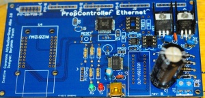

| * Install the 2K EEPROM Chip (U6) P/N: 24AA025E48-I/SN-ND (Orientation Note) | | * Install the 2K EEPROM Chip (U6) P/N: 24AA025E48-I/SN-ND (Orientation Note) |
| * Install the 512K EEPROM Chip (U2) P/N: 24LC512-I/P-ND (Orientation Note) | | * Install the 512K EEPROM Chip (U2) P/N: 24LC512-I/P-ND (Orientation Note) |
| | ||[[Image:20.JPG|300px]] |
| * Install the four 150 Ohm 1/4W resistors (R 1, R 5, R 18, R 19) P/N: 150QBK-ND . The color bands are Brown, Green, Brown, Gold. The resistors have no polarity to worry about. | | * Install the four 150 Ohm 1/4W resistors (R 1, R 5, R 18, R 19) P/N: 150QBK-ND . The color bands are Brown, Green, Brown, Gold. The resistors have no polarity to worry about. |

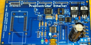

| | * Install the 33k Ohm 1/4W resistor (R 2). P/N: 33KQBK-ND. The color bands are Orange, Orange, Orange, Gold. The resistors have no polarity to worry about. |
| | ||[[Image:21.JPG|300px]] |
| * Install the 220 Ohm 1/4W resistor (R 3). P/N: 220QBK-ND. The color bands are Red, Red, Brown, Gold. The resistors have no polarity to worry about. | | * Install the 220 Ohm 1/4W resistor (R 3). P/N: 220QBK-ND. The color bands are Red, Red, Brown, Gold. The resistors have no polarity to worry about. |

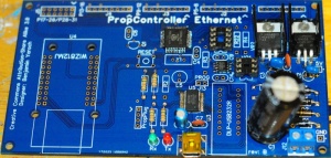

| * Install the 5MHz Crystal (X1) P/N: XC1711-ND. There is no polarity or orientation to worry about. | | * Install the 5MHz Crystal (X1) P/N: XC1711-ND. There is no polarity or orientation to worry about. |

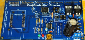

| * Install the 5mm Red/Green LED (L3) P/N: 754-1278-ND (Orientation Note) | | * Install the 5mm Red/Green LED (L3) P/N: 754-1278-ND (Orientation Note) |
| * Install the Reset Switch (PB1) P/N: 450-1650-ND. (Orientation Note) | | * Install the Reset Switch (PB1) P/N: 450-1650-ND. (Orientation Note) |

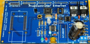

| * Install the Transistor (Q1) P/N: P2N2222AGOS-ND. Make sure the body of the package lines up with the silkscreen on the PCB. | | * Install the Transistor (Q1) P/N: P2N2222AGOS-ND. Make sure the body of the package lines up with the silkscreen on the PCB. |
| | ||[[Image:25.JPG|300px]] |
| * Install the Female Headers P/N: S7078-ND for the WizNet Module. They have no orientation, but make sure they sit flush with the PCB. | | * Install the Female Headers P/N: S7078-ND for the WizNet Module. They have no orientation, but make sure they sit flush with the PCB. |

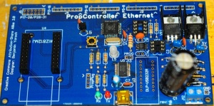

| * Install the four 8-Position Male Headers (J1 - J4) P/N: WM4206-ND. Be sure they sit flush with the PCB. (It is helpful to tack 1 pin down and re-adjust if necessary) | | * Install the four 8-Position Male Headers (J1 - J4) P/N: WM4206-ND. Be sure they sit flush with the PCB. (It is helpful to tack 1 pin down and re-adjust if necessary) |
| * Install the 12-Position Male Header (J5) P/N: WM8124-ND. Be sure it sits flush with the PCB. (It is helpful to tack 1 pin down and re-adjust if necessary) | | * Install the 12-Position Male Header (J5) P/N: WM8124-ND. Be sure it sits flush with the PCB. (It is helpful to tack 1 pin down and re-adjust if necessary) |

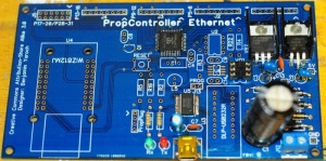

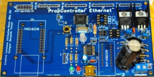

Main Board
- Install the Propeller IC (U1) P/N: P8X32A-Q44-ND. (Orientation Note)
- Install the 2K EEPROM Chip (U6) P/N: 24AA025E48-I/SN-ND (Orientation Note)
- Install the 512K EEPROM Chip (U2) P/N: 24LC512-I/P-ND (Orientation Note)
- Install the four 150 Ohm 1/4W resistors (R 1, R 5, R 18, R 19) P/N: 150QBK-ND . The color bands are Brown, Green, Brown, Gold. The resistors have no polarity to worry about.
- Install the 33k Ohm 1/4W resistor (R 2). P/N: 33KQBK-ND. The color bands are Orange, Orange, Orange, Gold. The resistors have no polarity to worry about.
- Install the 220 Ohm 1/4W resistor (R 3). P/N: 220QBK-ND. The color bands are Red, Red, Brown, Gold. The resistors have no polarity to worry about.
- Install the 5MHz Crystal (X1) P/N: XC1711-ND. There is no polarity or orientation to worry about.
- Install the 5mm Red/Green LED (L3) P/N: 754-1278-ND (Orientation Note)
- Install the Reset Switch (PB1) P/N: 450-1650-ND. (Orientation Note)
- Install the Transistor (Q1) P/N: P2N2222AGOS-ND. Make sure the body of the package lines up with the silkscreen on the PCB.
- Install the Female Headers P/N: S7078-ND for the WizNet Module. They have no orientation, but make sure they sit flush with the PCB.
- Install the four 8-Position Male Headers (J1 - J4) P/N: WM4206-ND. Be sure they sit flush with the PCB. (It is helpful to tack 1 pin down and re-adjust if necessary)
- Install the 12-Position Male Header (J5) P/N: WM8124-ND. Be sure it sits flush with the PCB. (It is helpful to tack 1 pin down and re-adjust if necessary)
- Install the 2-Position Male Header (J13) P/N: WM8072-ND. Be sure that it sits flush with the PCB. (It is helpful to tack 1 pin down and re-adjust if necessary)
