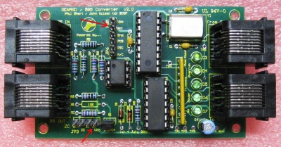

- With WayneJ's SS line of boards, the Ren-W draws its +5vdc power from the left pin of the board’s JP3 header (photo above); the ground power connection is made when the Ren-W is connected to either of the SS controller's RJ45 jacks. If you used the open jumper shunts to make your cable, simply plug the shunts into the JP3 headers on both the SS controller and the Ren-W.

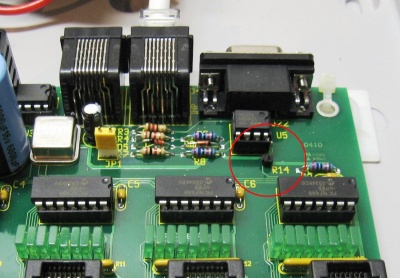

- With Wjohn's Ren64 (version XC5) there is a small, unmarked +5vdc test point immediately below pin 8 of U5 (the rightmost ST485BN chip) and just left of R14. Solder-in a single header pin if you like such as the example above (red circle).
