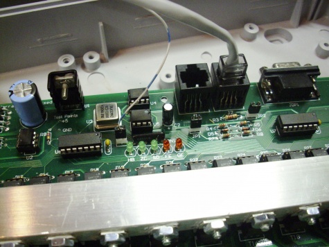

- A nifty solution that retains the SS controller’s ability to use the diagnostic LEDs is to solder each end of a single strand of cat5 wire to an open jumper shunt (LEFT photo above) and simply plug the shunts into the JP3 headers on both the SS controller and the Ren-W. Alternately, you may wish to make your own power cable using two female SL connectors; use a small piece of shrink tubing around the connector for insulation safety. (Both pins on the Ren-W’s JP3 header are +5vdc; both JP4 pins are ground connections.)
- The Ren-W draws its +5vdc power from the Renard SS board via the left pin of the Renard’s JP3 header; the ground power connection is made when the Ren-W is connected to either of the SS controller's RJ45 jacks. (MIDDLE photo above)
- With Frank Kostyun's Ren24 ver 3.3, +5vdc can be taken at TP2 (test point 2). You may drill a small hole in the pad if you wish to solder-in a single pin header. With the Ren24LV (RIGHT photo above) the red circles show places where 5vdc can be found: TP2 and the "Power Tie." The power tie includes six places for jumper header pins, the TOP LEFT of which carries +5vdc. Remember, ground is made automatically when the cat5 cable is plugged in.
- With Wjohn's Ren64 (version XC5) there is a small, unmarked +5vdc test point immediately below pin 8 of U5 (the rightmost ST485BN chip) and just left of R14. Solder-in a single header pin if you like.
- With Wjohn's Ren-C, +5vdc can be taken from the header pin immediately to the left of the Q1 transistor. The pin is marked VCC. Another +5vd VCC location is the 2nd from the top pin of the 6-pin JP6 programming header. Either location is fine.
