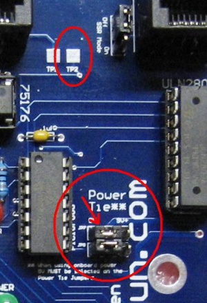

:::::[[File:Ren-w_jumper-connector.JPG |300px]] [[File:Ren-w_mount3.JPG |400px]] | :::::[[File:Ren-w_jumper-connector.JPG |300px]] [[File:Ren-w_mount3.JPG |400px]] [[File:Ren24LV_5vdc.JPG |300px]] | ||

::* With Frank Kostyun's Ren24 ver 3.3, +5vdc can be taken at TP2 (test point 2). You may drill a small hole in the pad if you wish to solder-in a single pin header. | ::* With Frank Kostyun's Ren24 ver 3.3, +5vdc can be taken at TP2 (test point 2). You may drill a small hole in the pad if you wish to solder-in a single pin header. Above and to the right is a picture of the Ren24LV, the red circles show places where 5vdc can be found: TP2 and the "Power Tie." The power tie includes six places for jumper header pins, the TOP LEFT of which carries +5vdc. | ||

- With Frank Kostyun's Ren24 ver 3.3, +5vdc can be taken at TP2 (test point 2). You may drill a small hole in the pad if you wish to solder-in a single pin header. Above and to the right is a picture of the Ren24LV, the red circles show places where 5vdc can be found: TP2 and the "Power Tie." The power tie includes six places for jumper header pins, the TOP LEFT of which carries +5vdc.
