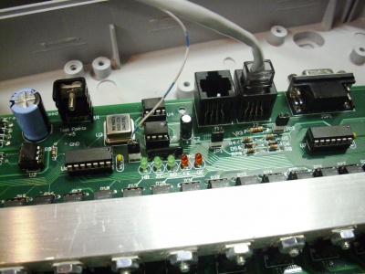

Mounting a Ren-W and SS24 Controller in a CG2000 Enclosure
Using side-entry RJ45s on the Ren-W and looping a cat5 cable from the Ren-W to the SS24, stress is minimized on all RJ45 connectors and the case can easily be fully opened. The Ren-W is mounted at the top of the case, to minimize magnetic interference from the SS24's transformer, and the SS24 is mounted diagonally in the CG2000 case to allow room for the antenna as well as a little additional distance from the triacs, another potential source of interference.
