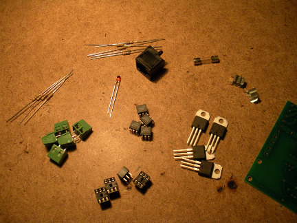

# Sort your parts in the order of assembly. This sounds odd but really helps especially if you have never done this type of assembly before. | # Sort your parts in the order of assembly. This sounds odd but really helps especially if you have never done this type of assembly before.[[File:SSRez_Step1.jpg]] | ||

- Sort your parts in the order of assembly. This sounds odd but really helps especially if you have never done this type of assembly before.
