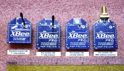

:XBee RF modules come in a standard and a "pro" version, and they operate in the 2.4ghz frequency spectrum. The modules do not interfere with wireless computer networks that also operate at 2.4ghz. The lower-powered standard version is said to have a line-of-sight transmission range upwards of 300 feet while the more powerful “pro” version is only ¼” larger and has a line-of-sight range upwards of a mile. In actual use, the distances are quite probably less than the stated specifications, especially considering the modules will likely be housed inside a protective non-metallic box of some kind. Mounting inside a metal box is not advised as it will severely hamper effective transmission distance.
[[File:xbee_radio_modules.JPG|500px ]]
:The antenna type on an XBee module can make a difference, too. The short, 1" wire antenna will provide better coverage than the flat, on-chip antenna. A version is also available with an antenna connector, presumably for a external directional antenna and even greater range potential. There is no significant price difference for the different antenna types and all are available for both the standard and pro versions. Suggestion: If using the Ren-W in normal repeater mode, consider using the lower powered, lesser expensive standard module for receiving and the more powerful pro module for transmitting, depending, of course, on the transmission distance needed.

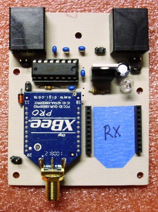

  • Receive only mode: only one XBee module is required, plugged into the XBee RX (right) side of the Ren-W board.
  • Transmit only mode: only one XBee module is required, plugged into the XBee TX (left) side of the Ren-W board.
  • Repeater mode: two XBee modules are needed, one for each side of the Ren-W board. One will receive, the other will retransmit the Vixen commands to the next Ren-W.
  • E-mode repeater: only one XBee module is needed to perform the repeater functions. Because a single XBee module must perform receive/transmit sequentially instead of simultaneously, small periodic delays in propagating the Vixen commands to the next Ren-W unit may occur. Note also that E-mode requires the use of the alternate PTP configuration scheme, outlined below, as well as a jumper across JP5.
Other than the power difference and slightly larger physical size of the “pro” version, the modules are interchangeable, pin-for-pin identical, and the configuration settings are identical as well. However, consider that the “pro” version has 10x the transmitting power of its lower-powered sibling, and it has a more sensitive receiver, too. These two factors make it the XBee module of choice for the Ren-W.

Ren-C Note: When Ren-W is connected to a Ren-C's RS-IN jack, it is necessary to install a balun on the cable between the Ren-W and the Ren-C. The balun will reduce the EMI interference that the XBee module creates in the cat5 wire. Without the balun, the Ren-C will likely experience framing errors and no communication with the Ren-W. (Radio Shack part# 273-0069)
