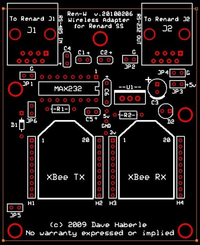

  • Qty -- Description (Ren-W Part)
  • 1 or 2 -- RJ45 jacks, side or top entry (J1, J2) Mouser# 571-5520251-4 (side entry) 571-5556416-1 (top entry)
  • 6 -- 2-pin vertical PCB headers (JP1-JP6) Mouser# 538-22-03-2021 (fewer may be necessary – see note below)
  • 2 -- 1 uf capacitors (non-polarized)(C1, C2) Mouser# 810-FK24Y5V1H105Z
  • 1 -- 100uf, 16v electrolytic capacitor (C3) Mouser# 647-UVR1C101MDD
  • 1 -- 3.3v 1w zener diode (D1) Mouser# 583-1N4728A-B
  • 1 -- 33 ohm ¼w resistor (R1) Mouser# 291-33-RC (299-33-RC 1/8 watt is also okay)
  • 1 -- 1k ohm ¼w resistor (optional) (R2) Mouser# 291-1K-RC (299-1K-RC 1/8 watt is also okay)
  • 1 -- LED (any color – optional) (D2) Mouser# 604-WP7104GT (green transparent)
  • 1 -- 16-pin DIP socket (optional) Mouser# 571-1-390261-4
  • 1 -- 3.3v positive voltage regulator (U1) Mouser# 595-UA78M33CKCSE3
  • 1 -- RS-232 Interface ICs Dual EIA-232 Driver Mouser# 595-MAX232N
  • 1 -- XBee Wireless RF modules Mouser# 888-XBP24-AWI-001 (pro version)
  • 2 -- Female SL Connectors (optional) Mouser# 538-16-02-0102
  • 1 -- Ren-W circuit board (etch your own in the true DIYC spirit!)
  • 2/4 -- 2mm x 10-pin XBee female headers (H1-H4) Mouser# M22-7131042 or also available from SparkFun Electronics as part# PRT-08272 ($1 each)
Step-by-step Construction
1. Solder 2mm female headers at locations H1, H2, H3, H4 or:
TX only: only H1, H2 are required
RX only: only H3, H4 are required
E-mode repeater: only H1, H2 are required.
Normal repeater mode: all four headers required
2. Solder the 16-pin DIP socket into the MAX232 location (skip if no socket is used and the MAX232 is to be soldered directly to the Ren-W board) .
3. Solder capacitors C1, C2. No polarity is required.
4. Solder electrolytic capacitor C3. Note the polarity: the + side into the square pad (top) closer to jack J2.
5. Solder 2-pin headers JP1, JP2, JP3, JP4, JP5, JP6. (Note: JP1 and JP2 are optional.)
6. Solder RJ45 jacks J1, J2
TX only: only J1 is required
RX only: only J2 is required
Normal repeater and E-mode repeater: both J1 and J2 are required
7. Solder zener diode D1. Note the polarity – the band on the diode must be facing up, next to header JP6.
8. Solder resistors R1 (orange-orange-black) and R2 (brown-black-red). R2 is only required if the optional power LED (D2) is used. No polarity concerns.
9. Solder the optional power LED at position D2. Note the polarity – the flat side/cathode/shorter lead faces to the mounting hole immediately to the right of D2.
10. Solder the 3.3v voltage regulator U1. The heat sink side faces toward JP2 (top). The need for an additional heat sink is highly unlikely as the supply voltage is only 5vdc.
11. Install the MAX232 and XBee module(s) in their respective sockets. Note the position of pin 1.
12. Install optional jumper shunts at JP5 and JP6 if necessary (see documentation).

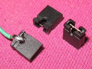

The Ren-W draws its +5vdc power from the Renard SS board via the left pin of the Renard’s JP3 header; the ground power connection is made when the Ren-W is connected to either of the SS controller's RJ45 jacks. A nifty solution that retains the SS controller’s ability to use the diagnostic LEDs is to solder each end of a single strand of cat5 wire to an open jumper shunt (see photo to the right) and simply plug the shunts into the JP3 headers on both the SS controller and the Ren-W. Alternately, you may wish to make your own power cable using the two female SL connectors; use a small piece of shrink tubing around the connector for insulation safety. (Both pins on the Ren-W’s JP3 header are +5vdc; both JP4 pins are ground connections.)
Connecting the Ren-W to a Renard SS Controller• Connect JP3 to JP3 on the SS to power the Ren-W (5vdc).
  • Ren-W as a transmit only node: connect only J1 to J1 on the SS. Leave J2 on the Ren-W unconnected.
  • Ren-W as a receive only node: connect only J2 to J2 on the SS. Leave J1 on the Ren-W unconnected.
  • Ren-W as a standard repeater: connect J1 to J1 and J2 to J2 on the SS.
  • Ren-W as an E-mode repeater: connect J1 to J1 and J2 to J2 on the SS, add a jumper on the Ren-W’s JP5 and make sure the Ren-W has only a single XBee module plugged into the TX (left) position.
What are JP1, JP2 and JP6 used for?
JP1 is an optional RS-485 input connection. Because an XBee module can be programmed via serial communications using a simple AT commands from within a terminal program such as Windows Hyperterminal, these headers provide external access to the R1IN (pin 13, JP1) and T1OUT (pin 14, JP2) serial connections of the MAX232 chip, which in turn, communicates with the XBee module. Both data and ground are provided; ground is the right pin and is marked with G. Using the XCTU software and an XBee programmer board is vastly more convenient that manually configuring a module using AT commands but Digi provides ample documentation for AT command line programming. You can also measure the input voltage of the RS-485 signal at JP1; an acceptable range is +3.3 to +4.8 vdc. It is not expected that this voltage will exceed 5vdc.
JP2 is an optional RS-232 output connection and can also be used to connect Ren-W to other serial devices. The output voltage is inverted and should be -5.0 to -5.5vdc, depending on the original input voltage.
Caution: never place a shunt jumper across JP1 or JP2, or across either pin of JP3 to either pin of JP4.
JP6 is used to bypass the 33ohm resistor R1 which helps moderate the RS-485 serial signal’s current. The combination of R1 and zener diode D1 form a voltage/current protection circuit that limits the serial voltage to a maximum of 3.3 volts before it enters the XBee module’s DIN port. However, not all RS-485 serial signals are of the same voltage and if your serial signal is less than +3.3 volts, you may find that the integrity of transmitted data may increase by placing a shunt jumper on JP6 to bypass resistor R1. If the serial signal is +3.8 vdc or greater, you should leave JP6 open. The XBee module includes a modicum of internal protection and in testing, we found that an XBee can accommodate +5vdc at the input DIN for a short period of time (a few seconds), after which the XBee may stop responding and appear to “lock up.” Temporarily removing power to the board usually resets the XBee so that it will function again.
Other Voltage Test Points
Almost in the exact center of the Ren-W board are three test points marked 5vdc, GND and 3vdc (actually 3.3v). While the actual voltages may vary slightly, the tested values should be very close to those figures. Our prototype measured 4.96v and 3.29v.
