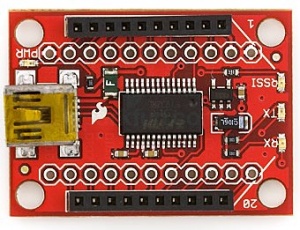

:You will need the free XCTU software from Digi International (www.digi.com) as well as an XBee programming board. An inexpensive programming board is available from SparkFun Electronics (www.sparkfun.com - XBee USB Explorer, SparkFun part # WRL-08687, about $25). Other programming boards are available and prices vary widely.

*1. Verify that the programmer board is unplugged from the USB port, and plug the XBee module into the board.
  • 1. Verify that the programmer board is unplugged from the USB port, and plug the XBee module into the board.
