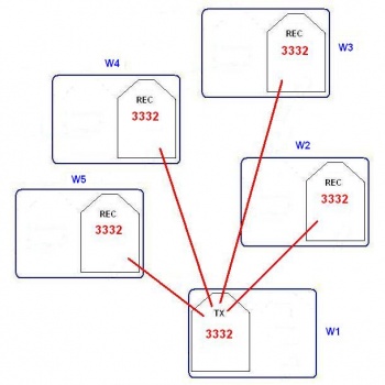

PAN ID concepts
Global broadcast
Configure all XBee modules with the same PAN ID (or just keep the default 3332). When the first one (e.g. the "master") transmits the Vixen control signals, all the other XBee modules will receive them simultaneously, and all the Renard SS controllers will respond identically. Example: for a 24-channel system, if SS8 controllers are mixed with SS16s and SS24s, the SS8s will respond to Vixen channels 1-8, the SS16s will respond to Vixen channels 1-16 and the SS24s will respond to Vixen channels 1-24.
In a global broadcast mode, only one Ren-W board is used as the master transmitter and all the other Ren-W boards are receivers only, so each Ren-W board would require only one XBee module. The design of a global broadcast network looks like the example to the right:
