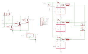

Schematic
Here is the Schematic diagram as captured from EAGLE.
click on the picture for a larger version of the REN48LSD hookup diagram
