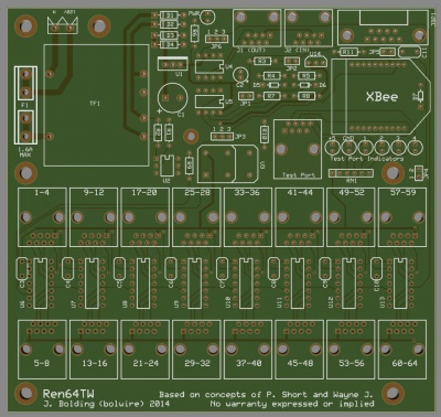

Introduction
The Ren64TW is a 64 channel board, using external SSRs. It has an on board power supply, and optional XBee support.
This board is currently in development by J. Bolding (bolwire). An initial run of 10 pcbs has been ordered for testing and verification.
Disclaimers
The Board
The board measurement is 5.825"W X 5.500"H, and the provided mounting holes are placed to align with a CG-1500 demarcation enclosure.
Board Availability
The Ren64TW is currently under development and not available at this time.
Inquires should be directed to bolwire here on the DIYC forum.
PCBs should be expected to be available no earlier than June 2014, however if that changes I will update as needed.

The Ren64TW has a jumper for just about any configuration you would like to use.
Jumper JP1 & JP2:
For RS-232 (direct to PC) JP1 ON/JP2 OFF
For RS-485 (output from renard board or converter/adapater) JP1 OFF/JP2 ON, Try removing JP2 if communication issues occur.
Jumper JP3: Selects weather the incoming data is from a wired connection of XBee module
Jumper JP4: Enables XBee transmit
Jumper JP5: Resistor for XBee incoming data
Jumper JP6: Selects the standard renard method of passing data to the next controller, or to use bypass (thru) for DMX and Start Address firmware use
