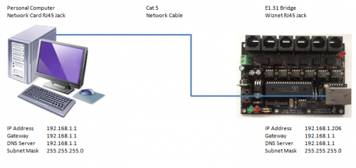

==Direct Connection PC to Device== | ==Direct Connection PC to Device== | ||
[[File:E131directconnect.png |500px]]<br/> | |||
It is possible to use a single ethernet cable to connect a E1.31 controller or bridge directly to a PC without other networking gear. E1.31 uses ether net connections (RJ45 cables). To connect directly, it is necessary to put the PC and the E1.31 on the same IP subnet, ie: that they both have an address that has the same first three IP address settings like: 192.168.1.x or 192.168.0.x By default many of the E1.31 devices come with a default address of 192.168.1.206. | It is possible to use a single ethernet cable to connect a E1.31 controller or bridge directly to a PC without other networking gear. E1.31 uses ether net connections (RJ45 cables). To connect directly, it is necessary to put the PC and the E1.31 on the same IP subnet, ie: that they both have an address that has the same first three IP address settings like: 192.168.1.x or 192.168.0.x By default many of the E1.31 devices come with a default address of 192.168.1.206. | ||
For assistance setting the IP address in a PC:
