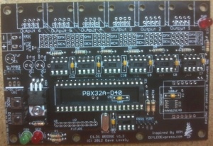

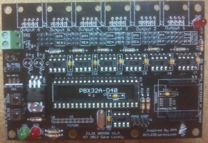

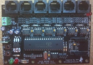

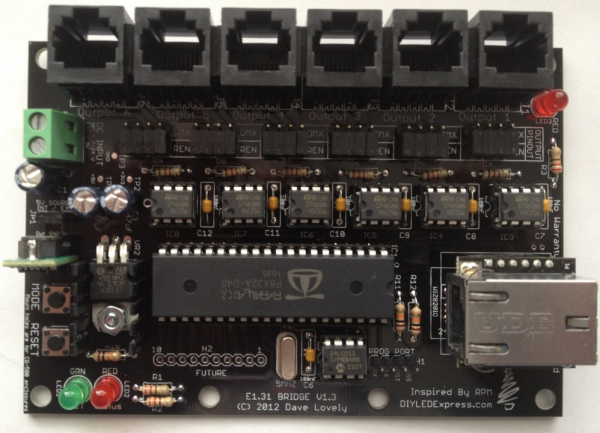

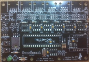

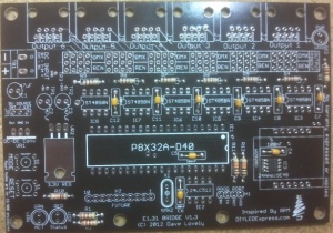

the lowest profile parts first and ending up with the tallest.
the lowest profile parts first and ending up with the tallest.  You can click on any photo to see a larger version of the image.

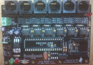

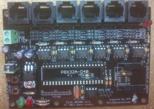

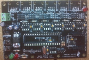

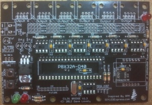

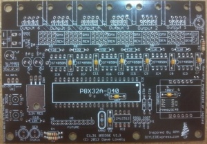

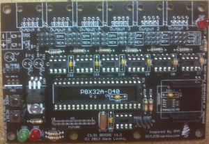

[[File:E1_31Bridge.png|600px]]

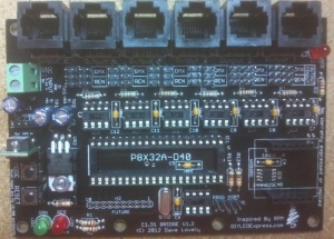

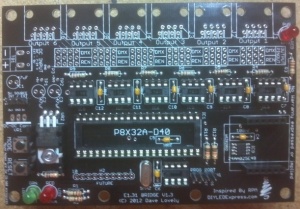

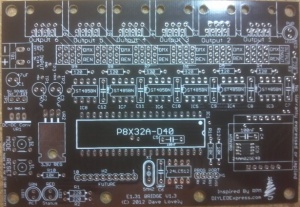

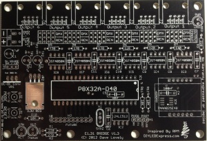

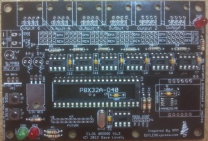

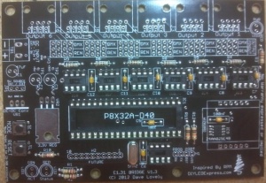

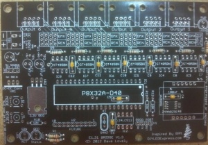

#<span style="font-size:21px">□</span> Begin by inspecting the PCBs to look for any defects such as cracks or breaks.  The holes on the board should be open on both sides.  Then inspect and sort out the various parts for the boards.

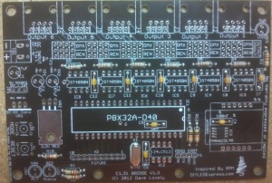

#:[[File:E131bridgepcb.jpg|300px]]

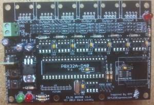

#<span style="font-size:21px">□</span>  Install the MAC IC, this is the only surface mount IC. It is optional if you are not comfortable with soldering surface mount ICs.  The firmware will generate a random MAC ID if the IC is not installed.  The IC is polarized and the IC must be installed so that the dot on the package aligns with the dot on the pcb, the lower right side of the pad.  For hints on how to solder a SMT device look [https://www.sparkfun.com/datasheets/Prototyping/General/SolderingBasics.pdf here].
#<span style="font-size:21px">□</span>  '''README: DO NOT install the MAC address IC unless you have a Prop Plug to load version 4.02 or greater.''' Install the MAC IC (IC9), this is the only surface mount IC. It is optional if you are not comfortable with soldering surface mount ICs.  The firmware will generate a random MAC ID if the IC is not installed.  The IC is polarized and the IC must be installed so that the dot on the package aligns with the dot on the pcb, the lower right side of the pad.  For hints on how to solder a SMT device look [https://www.sparkfun.com/datasheets/Prototyping/General/SolderingBasics.pdf here].
#:[[File:E131Bridge1-3-Step-1.jpg|300px]]

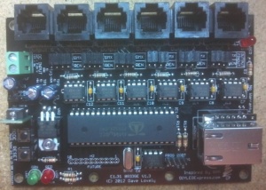

#<span style="font-size:21px">□</span>  Install the WizNet adapter with the RJ45 socket facing the Propeller IC.
#<span style="font-size:21px">□</span>  Install the WizNet adapter with the '''RJ45 socket facing the Propeller IC.'''
#:[[File:E131Bridge1-3-Step-22.jpg|300px]]

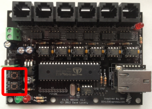

#<span style="font-size:21px">□</span> On initial power up and test perform a Hard Reset to initialize the settings. To do a hard reset  Press the MODE and RESET buttons at the same time and hold down the MODE button while you release the RESET button.  The ACT LED will flash a status code, after the ACT LED flashes 10 times, release the MODE button.  This will wipe all device configuration settings and reset them to the default factory settings and will force the generation of a new random [http://en.wikipedia.org/wiki/MAC_address MAC ID] for the unit if the MAC ID chip (IC 9) is not installed on the board.
#:[[File:E1 31Bridge Reset.png|300px]]

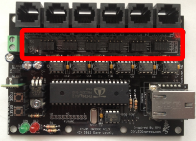

====Output Configuration Jumpers====
[[file:E1_31Bridge_REN.png |400px]]
[[File:E1_31Bridge_REN_Zoom.png |300px]]
Each port has a set of four separate jumpers. These jumpers set the wiring configuration on their respective output jacks. If you want a DMX wiring output, you need to put all four jumpers to the "DMX" side. If you want a Renard wiring output, you need to put all four jumpers to the "REN" side. '''It is important that all four jumpers are in the same position for that port. Note that the protocol for the port is different than the wired output.  You must set the DMX or Renard output protocol via the Bridge configuration settings.'''

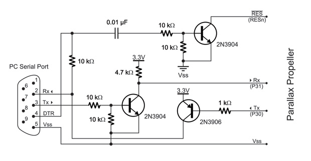

====Build your own====
====Build your own Programming Interface====
If you do not have access to a PropPlug, but you do have a PC with a true serial port, it is possible to build a simple interface to program the E1.31 bridge using simple common parts you can find from many vendors.  However, the low cost PropPlug with it's USB interface works best on most modern computers.<br/>
[[File:SerialToPropeller.jpg]]

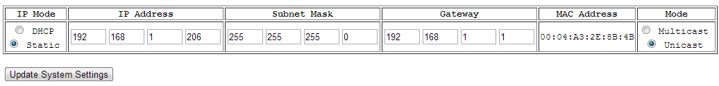

===IP Address Configuration===
The default IP address and mode of the bridge when initially setup is 192.168.1.206 and is a static IP address.  This can be later changed thru the web interface to what ever network address you need.  '''Note that all E1.31 bridges and the E682 Pixel controller all use this default IP address, so if you have multiple devices on the same network, you must change the static address of the units to avoid a conflict.'''

==Firmware Version 3.x+ Configuration==
[[File:BridgeConfigPage.png]]
===System Settings===
[[File:SystemSettings.png]]
IP Mode: Sets Static or DHCP IP address Mode<br/>
IP Address: The IP Address of the Bridge<br/>
Subnet Mask: The Subnet Mask of the Bridge<br/>
Gateway: The Gateway Address<br/>
MAC Address: The MAC Address of the MAC IC or Auto generated MAC Address<br/>
Mode: Sets the Bridge in Multicast or Unicast Mode<br/>
After making changes to any of the settings above click "Update System Settings" to save these setting.

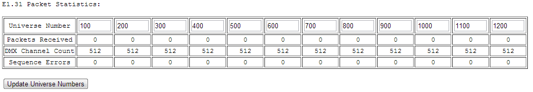

===Universe Settings===
[[File:UniverseNumbers.png]]
Universe Number: Defines the Universe numbers the Bridge will use, 6 are available in Multicast Mode (Unusable ones are grayed out) and 12 are available in Unicast Mode. All numbers should be unique.<br/>
Packets Received: The number of packages received on this universe.<br/>
DMX Channel Count: The number of channels sent in the E1.31 Universe packet.<br/>
Sequence Errors: The number of out of order packets received. NOTE: There is a bug in some of the transmitting E1.31 plugins where sequence numbers are not sequential per Universe. <br/>
After making changes to the Universe numbers above click "Update Universe Numbers" to save these setting.

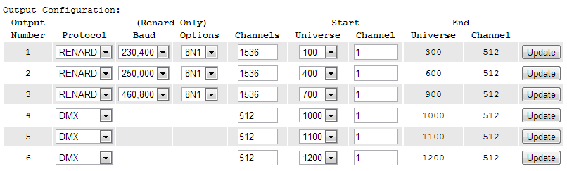

===Output Configuration===
[[File:OutputConfiguration.png]]
Output Number: The output jack number.<br/>
Protocol: The Protocol used for the output.<br/>
Baud (Renard Only): Sets the Renard Output Serial Baud Rate.<br/>
Options (Renard Only): Defines the output formate, Normally use 8N1, 8M2 is for solving issues with higher channel counts for RenW setups.<br/>
Channels: The number of channels on this output. (Note DMX has a max of 512 Channels)<br/>
Start Universe: Define the universe number of the starting channel.<br/>
Start Channel: The starting channel for this output.<br/>
End Universe: Auto calculated ending Universe Number.<br/>
End Channel: Auto calculated ending Channel Number.<br/>
After making changes to each output number click "Update" to save the changes for that output.

==Hardware Reset==
===SOFT RESET===
By pressing and releasing the RESET button, you can force a soft reboot of the E1.31 bridge and it will restart with all of the programmed parameters that you have configured the device to.  This is a non destructive reboot and all settings remain intact after the reboot.
===HARD RESET===
It is possible to do a hard reset and erase all of the configured parameters in the E1.31 bridge and return it back to the factory default settings.  To do the hard reset and lose all of your settings and return the device to the factory settings: Press the MODE and RESET buttons at the same time and hold down the MODE button while you release the RESET button.  The ACT LED will flash a status code, after the ACT LED flashes 10 times, release the MODE button.  This will wipe all device configuration settings and reset them to the default factory settings and will force the generation of a new random [http://en.wikipedia.org/wiki/MAC_address MAC ID] for the unit if the MAC ID chip (IC 9) is not installed on the board.

Building the 6 Port E1.31 Bridge
The 6 Port E1.31 Bridge requires a fair bit of soldering so take your time and ensure you install the components in the correct orientation when required. Start by sorting the components by type and values. Look over the PCB before starting noting the location of the various components. Follow the standard procedure of installing the lowest profile parts first and ending up with the tallest. You can click on any photo to see a larger version of the image.
  1. Begin by inspecting the PCBs to look for any defects such as cracks or breaks. The holes on the board should be open on both sides. Then inspect and sort out the various parts for the boards.
  2. README: DO NOT install the MAC address IC unless you have a Prop Plug to load version 4.02 or greater. Install the MAC IC (IC9), this is the only surface mount IC. It is optional if you are not comfortable with soldering surface mount ICs. The firmware will generate a random MAC ID if the IC is not installed. The IC is polarized and the IC must be installed so that the dot on the package aligns with the dot on the pcb, the lower right side of the pad. For hints on how to solder a SMT device look here.
  3. Install the nine 0.1uF (100nF) capacitors C4-C12. The capacitors are not polarized and can be mounted either way.
  4. Install the three 220 Ohm resistors (red, red, brown, gold) R1-R3. The resistors are not polarized and can be mounted either way.
  5. Install the six 120 Ohm resistors (brown, red, brown, gold) R4-R9. The resistors are not polarized and can be mounted either way.
  6. Install the three 10K Ohm resistors (brown, black, orange, gold) R10-R12 The resistors are not polarized and can be mounted either way.
  7. Install the 5Mhz Crystal X1. The crystal is not polarized and can be mounted either way.
  8. Install the two push button switches S1-S2. The switches are polarized and will only fit on the board one way.
  9. Install the seven 8 pin IC sockets. The sockets are polarized and have a notch on one end. It should be mounted so that the notch is oriented to the left and matching the marking on the pcb.
  10. Install the one 40 pin socket. The sockets are polarized and have a notch on one end. It should be mounted so that the notch is oriented to the right and matching the marking on the pcb.
  11. Install the green ACT LED (LED1). Note that the LED is polarized and the long lead should face towards the top of the board. Note: silkscreen shows "FLAT" side of the LED, this can also be used to check for proper orientation
  12. Install the two red STATUS and POWER LEDs (LED2-LED3). Note that the LED is polarized and the long lead should face towards the top of the board. Note: silkscreen shows "FLAT" side of the LED, this can also be used to check for proper orientation
  13. Install the 3.3V Regulator VR2 with the heat sink. The voltage regulator is polarized and goes only one way. Gently bend the leads of the regulator at the location on the leads where it changes size down at a 90 degree angle towards the flat side of the regulator. Apply thermal grease to the flat heat sink side of the regulator and the heatsink and fasten it to the pcb using a #4 screw and nut.
  14. Install the 3 Pin headers JP1. The short end of the header is soldered to the pcb.
  15. Install the 4 Pin headers H1. The short end of the header is soldered to the pcb.
  16. Install the two WizNet 1x6 pin headers.
  17. Install the twelve 2x3 output selector pin headers. The short end of the headers are soldered to the pcb.
  18. Install the power terminal block TB1. Install so that the wire openings face the edge of the pcb.
  19. Install the three 47uF Capacitors C1-C3. The capacitors are polarized and can only be installed one way. The side of the capacitor will have a stripe on the negative side. The long lead is the positive side, and it goes in the hole marked with a + to the right.
  20. Install the DC-DC Converter VR1. The voltage regulator is polarized and must only be installed one way. The flat side of the voltage regulator must be mounted towards the bottom of the board, aligning with the stripe on the pcb.
  21. Install the six RJ45 jacks J1-J6. The jacks are polarized and they have to be installed with the correct orientation. Gently install all 8 pins into the holes and them firmly press down on the socket to seat the plastic pins in the holes in the PCB.
  22. Install the six RT485BN in IC3-IC8 with the notches facing the left edge with the power terminal block.
  23. Install the EEPROM in IC2 with the notch facing the left edge with the power terminal block.
  24. Install the Propeller in IC1 with the notch facing the WizNet adapter to the right.
  25. Install the WizNet adapter with the RJ45 socket facing the Propeller IC.
  26. On initial power up and test perform a Hard Reset to initialize the settings. To do a hard reset Press the MODE and RESET buttons at the same time and hold down the MODE button while you release the RESET button. The ACT LED will flash a status code, after the ACT LED flashes 10 times, release the MODE button. This will wipe all device configuration settings and reset them to the default factory settings and will force the generation of a new random MAC ID for the unit if the MAC ID chip (IC 9) is not installed on the board.
H2 will be unpopulated as it is for future expansion.
Congratulations! That completes the construction of the 6 Port E1.31 Bridge!
Jumpers
There are two types of jumper groups on the E1.31 bridge. The first is to set the input voltage and the others to set the desired DMX or Renard physical output.
Power Jumper - JP1
This jumper is used if you are supplying either a well regulated +5v or unregulated +7-24v. If you apply +5vdc to the terminal block, you should put the jumper on the "EXT" setting (indicating you are getting 5v externally). If you apply +7-24vdc, you should put the jumper on the "INT" setting (indicating you are getting 5v internally via the 5v regulator).
You MUST ensure you have this jumper set correctly if you are using voltages greater than 5v as it may (and probably will) cause permanent damage to some components on the board. The Propeller chip uses 3.3v and would be fine but the RS-485 transceivers are 5v devices and would be probably be damaged.
Each port has a set of four separate jumpers. These jumpers set the wiring configuration on their respective output jacks. If you want a DMX wiring output, you need to put all four jumpers to the "DMX" side. If you want a Renard wiring output, you need to put all four jumpers to the "REN" side. It is important that all four jumpers are in the same position for that port. Note that the protocol for the port is different than the wired output. You must set the DMX or Renard output protocol via the Bridge configuration settings.
System Settings
Universe Settings

So - you've built your new 6 Port E1.31 Bridge, connected it up to your computer and tried a quick sequence and nothing happens! There are several checks to perform in order:
Visual Inspection
The very first step involves a close visual inspection of the board. Double check that you have the correct component in the correct location and in the correct orientation. Look at every single solder connection and if some are not shiny or look suspect - reflow them to be sure.
Power
Measure the voltage supplied to the bridge and ensure it's either +5vdc or +7-24vdc and ensure the power jumper is set correctly. Measure the voltage with the supply plugged in and connected to the bridge to ensure it's not shorting out. If the voltage is correct then you know the input level is correct.
Remove any/all socketed chips from the board before proceeding.
If you are using the +5vdc option (EXT), you need to make some measurements of the 3.3v regulator or VR2.
Measure the input voltage between pins 1 and 2 - it should measure 5v (same as the input) - if it isn't then reflow the terminal block, 3.3v regulator and power jumper and check again.
Measure the output voltage between pins 3 and 2 - it should measure 3.3v - if it is much above 3.3v, it's likely the regulator is bad. If it is close to 0v, you may have a short somewhere on the board. Inspect the traces coming from pin 3 over the board and look for solder bridges. If you cannot find a short, then you may have to replace the 3.3v regulator.
If you are using the +7-24vdc option (INT), you need to make some measurements of the 5.0v regulator or VR1.
Measure the input voltage between pins 1 and 2 - it should measure 7-24v (same as the input) - if it isn't then reflow the terminal block, 5.0v regulator and power jumper and check again.
Measure the output voltage between pins 3 and 2 - it should measure 5.0v - if it is much above 5.0v, it's likely the regulator is bad. If it is close to 0v, you may have a short somewhere on the board. Inspect the traces coming from pin 3 over the board and look for solder bridges. If you cannot find a short, then you may have to replace the 5.0v regulator. Another option is a bad 3.3v regulator. If possible, try a +5v supply with the EXT setting and determine if the 3.3v supply is OK using the measurements above. If it is, then you know the 3.3v regulator is OK. If this is not possible, remove the 3.3v regulator and measure the 5.0v regulator output again. If it is 5.0v as it should be, then the 3.3v regulator was bad and needs to be replaced.
Hardware Reset
SOFT RESET
HARD RESET
It is possible to do a hard reset and erase all of the configured parameters in the E1.31 bridge and return it back to the factory default settings. To do the hard reset and lose all of your settings and return the device to the factory settings: Press the MODE and RESET buttons at the same time and hold down the MODE button while you release the RESET button. The ACT LED will flash a status code, after the ACT LED flashes 10 times, release the MODE button. This will wipe all device configuration settings and reset them to the default factory settings and will force the generation of a new random MAC ID for the unit if the MAC ID chip (IC 9) is not installed on the board.
