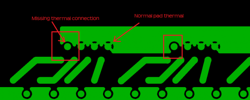

'''Boards/Kits purchased after Aug 2013 are a new batch that has the correction on pin 7.'''<br/> | |||
'''PRE Aug 2013 Boards Only -- NOTE -- If you purchased a Ren48LSD board from diyledexpress then you should know that there was a slight mistake on the board files. Pin 7 of ALL the RJ45 outputs is not connected to anything. To use that pin, you must run a small jumper from pin 5 to pin 7 or simply blob up some solder between the two pins. This will ensure the common V+ is distributed properly to all four odd pins on the outputs.''' | |||
'''You can tell if you have one of these boards by inspecting the underside of the board'''<br/> | |||
