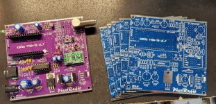

Hey! It's amazing what pops up when you spring clean. I have 5 blank boards and 1 with all the soldered parts. It does not have the ESP32 TTGO- T8 board nor do I have any spare parts. Just what's in the Pic. Let me know if you want anything.
Maybe I need to put it up for bid? LOL!
lightsonlipan was the first to ask, I just didn't find anything until now.
$5.00 plus shipping. Give me a pm and we'll go from there.
