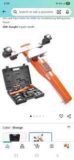

Hello all. I was wondering what everyone used to bend their pipes or tubes for their displays? I was thinking about buying something like this. Please let me know if this would work for bending a frame for an arch ECT...
